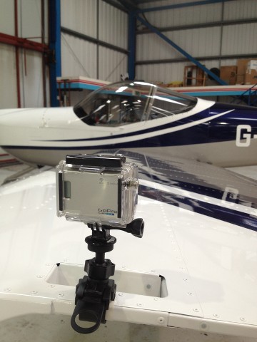

I fabricated a GoPro mount for the RV12 wing handle last night and went flying today.
A friend CNC'd a part and I used scrap aluminum to frame the opening of the hand hold.
It is held by two screws sandwiching the top and bottom between the wing hand hold) and foam takes up the volume of the opening. I used foam to protect the paint and file the volume inside of the hand hold in the wing.
This way I didn't permanently attach it to the wing. The top and bottom sandwich it to hold it in place. Easy on in a minute and padded with weather strip to protect the paint, thanks Bob for the CNC machining.
A few pictures from that view, am still amazed how the little GoPro camera performs
![072514 a.jpg](/proxy.php?image=http%3A%2F%2Frv12pilot.com%2Fvaf%2F072514+a.jpg&hash=44527d956465e6f5d49356c6d6b40c1c)
![072514 b.jpg](/proxy.php?image=http%3A%2F%2Frv12pilot.com%2Fvaf%2F072514+b.jpg&hash=d554981b132823a15a1f76a26efaaa01)
![072514 c.jpg](/proxy.php?image=http%3A%2F%2Frv12pilot.com%2Fvaf%2F072514+c.jpg&hash=aaa064bd9a7cce99111562275bff9eb4)
