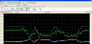

EM-6 Update
We did another ground run on our 6A today, logging to the card and testing various features, especially the closed loop area. Everything performed as expected (what a relief!).
I'll run a bit more on the ground and if all looks nominal, will conduct a test flight early next week, weather permitting. If that goes well, will get EM-6s into 2 other RVs ASAP, start building more time on Lycomings and testing the new features.
Exciting times.:)
Screenshot from the logs using the new V7.1 software.

Up again in the the RV-10 this morning testing the closed loop.
Many thanks to Les Kearney again for use of his airplane for testing the 6 cylinder Lycoming software. Invaluable.
