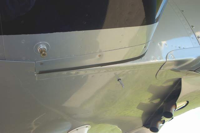

Checking with builders to see what the consensus is on covering the small hole under the fuse where the fuel tank vents.
I have expoxied small metal screen there in the past, but it eventually gets knocked off.
Is there a history of them getting plugged? I know positive pressure from the tank as it warms would attempt to push out a blockage.
Any thoughts appreciated.

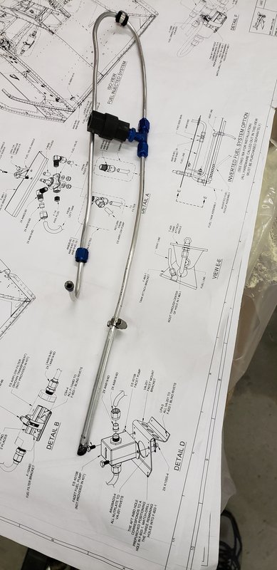

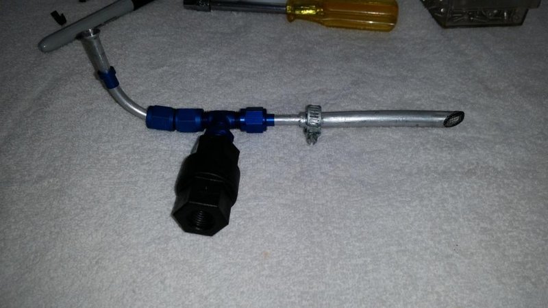

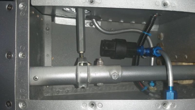

This is what I did for vent lines on the RV-10 (first two photos). I did a similar setup in the RV-8 (third photo). Note the transition from 1/4” to 3/8” tubing. This provided a better surface area to JB Weld on a small piece of aluminum screen. After the JB Weld sets a light touch on the Scotch Brite wheel and good to go. The aluminum screen is to keep out the mud dabblers. The screens are firmly in place.
The black nylon thing is a vacuum breaker (Check Valve). It open on just a slight vacuum as in the vent gets clogged with ice and the fuel pump draws a vacuum on the tank. This eliminates the issue of having a collapsed tank. This vacuum breaker is very light. I got it from McMaster. There are two models, one for water and one for fuel. Get the fuel one.

Carl that's pretty cool. Does the vacuum breaker ever leak fuel?
Nope - but to be fair there is not much exposure to fuel under normal circumstances as the air flow is into the tank. For those days where you fill up and the sun burps a little fuel out the vent there is fuel on it, but I never had a blue stain in the wing root where this is located.

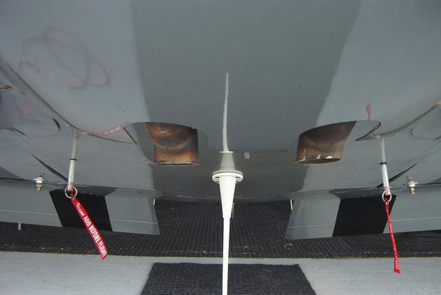

In Mud Dauber country, we never park (including inside) without flagged vent covers. They come off in preflight, and back on after landing. I defy the little critters to build faster than that..... ;)
