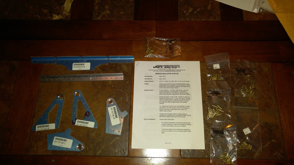

Since I am still building the wings, I ordered the SB kit so I can install it as part of the original construction. This kit is for the RV-10 and RV-14.
I received it yesterday and wrote up a short discussion of the contents here:
http://www.brunbergs.net/?p=533
So in other words, just as described in the service bulletin. Since my wings are largely assembled, I'll have to remove the old brackets to install the new, though I will have better access because the bottom skins are not on yet. In your case, you might ask if Van's has the revised plans, at least the pertinent pages, available, just to be sure there are no gotchas.

Email from Van's
I received the following e-mail from Van's yesterday:
Dear RV Builder,
Our records indicate that you received a Standard or QuickBuild Wing kit from Van's within the last year.
If you have not yet completed the wings, you may wish to install the parts for SB 06-03-28. You may already be aware of the SB. If not, it is available on our website:
http://www.vansaircraft.com/pdf/sb16-03-28.pdf
As noted in the SB, we do not advise any disassembly to install the parts. But if they can be easily installed during construction we recommend that you do it. If you choose not to do so, or if the wings are already completed, you can comply with the SB with inspections once your airplane is flying.
If one wing is complete and the other still open, it is acceptable to perform the SB on one wing only, if you wish.
Parts for the SB are available, as noted on the last page of the SB.
Happy Building,
Van's
