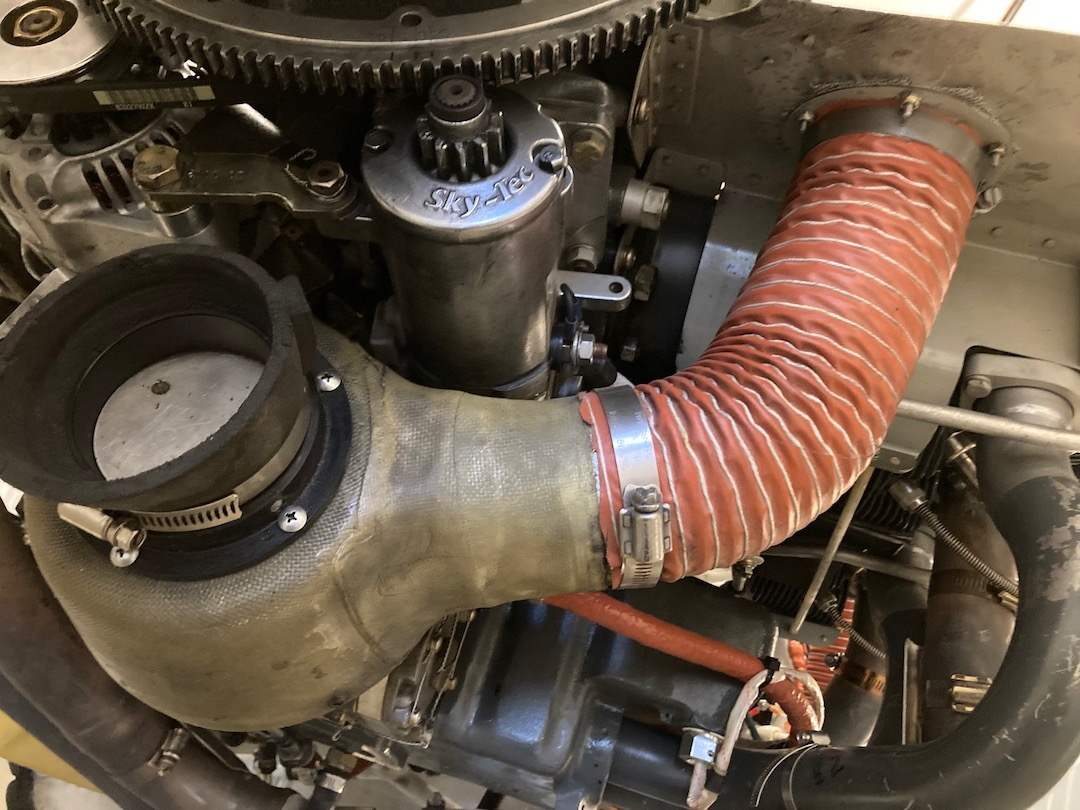

Anyone have photos of a Sam James MK3 Filtered Ram Air Kit installation on a RV-10 IO-540 with Airflow Performance FM-150 throttle body? Install suggestions would be welcome as well!

Hey Bill,
The Mk3 Filter is 50 % too small for the IO-540 .
It has been tested and flowed by Airflow Performance.

We are working hard on another option and hope to have a production solution before Oshkosh 2026

Thanks. I guess we'll go with the Vans stock solution for now, and check out your production solution hopefully at Oshkosh 2026.

As posted the MK-3 filter is too small for the IO-540.
I recently contacted HP aircraft on their offerings:
For me, the full time filter model is what I’ll go with. I’ll use the larger K&N RU 3600 filter for my CAS IO-540 with the FM-200. The RU 3600 measures out at a little over 70 square inches. The K&N guidance for an IO-540 engine at 2700 rpm is 70 square inches.
I’ll soon have the engine mounted and will take measurements to verify this fits.
Thank you Todd Nelson for putting me on this trail.

Thanks, I have used Van's FAB for 30 yrs, and yes the K&N can shrink, but that is not fatal. It can be replaced. It really is about FIT, of an updraft O-360. Also cost and time to build. I already have a part.
I would add IMHO the biggest negative of the VAN FAB is the tendency of the metal plate to crack. This is mitigated two ways: 1) support the front of the box. 2) the fit of the cowl to the airbox can be too tight, so the vibrations of engine and fixed cowl can fatigue metal plate.
In my case lower cowl will be modified to be "Sam James" like. The connection between cowl and FAB will be neoprene or SCAT duct. There will be FAB front support and flexibility between FAB and Cowl duct, which should eliminate base plate cracking. Also using a thicker metal plate than stock.
I really like the forward facing deal but I am committed to my updraft carb. I could change oil sump to fwd facing induction, buy FI and on and on.. and $$$ and $$$ and ⌚ and ⌚. I really like the simplicity of carburetor FAB, and I will accept filter shrinkage. It works. I do like the conical filter airboxes, but the MK1 airbox is really a work around of updraft... it does not make sense for me.
