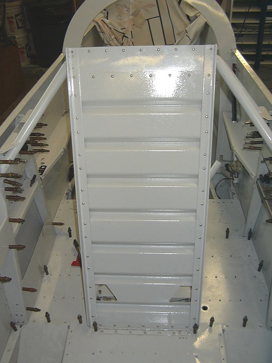

Was out at the airport and got a good look at the area. I've changed my mind. You would need to take out the canopy tracks, but not remove the cockpit rail. The rest is bolted and screwed. Shouldn't need to drill out any rivets. With the seatback and rear stick out of the way you could push it down and remove it that way.
The seat back however would also need to be modified. The F-832C angle is 28" in the plans, mine is 29" to accommodate the tall pilot mod. (Don't want the seat back to be able to fall past the weldment holding it up). Probably easier to make a new seat back rather than try to drill out and attach new angles. The F-832APP corrugated seat back part is the only expensive bit.

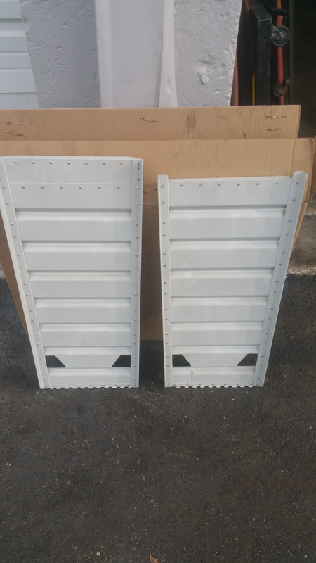

I actually just ordered the parts to remake that bit myself in something I'm calling the "Even taller pilot" mod to lift up the shoulder belts a bit. At a long torso 6' 4.75" or so the shoulder belts push down on my back uncomfortably.

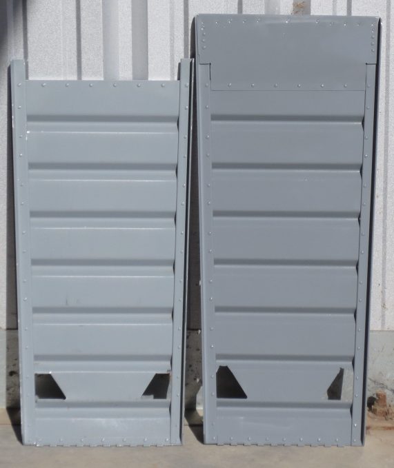

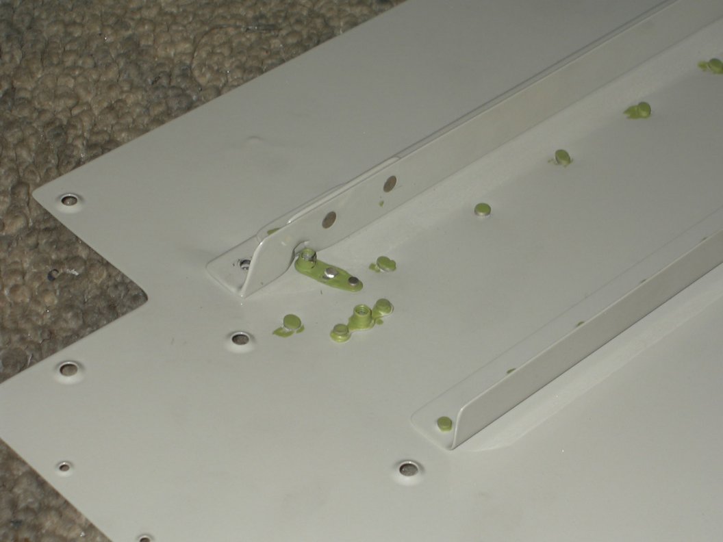

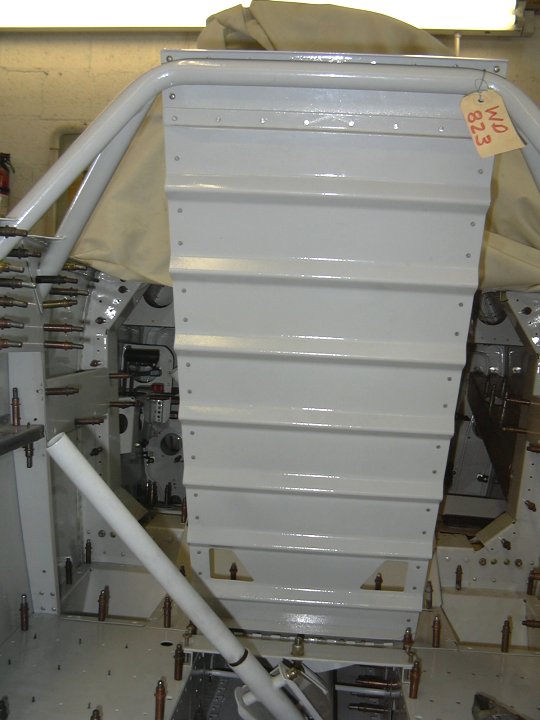

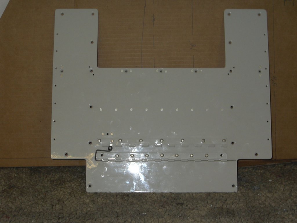

I have the "tall pilot" option weldment in my 8A [WD-823 if memory is still good]. I also have long legs. I added a second piano hinge 1.5" behind the stock hinge to improve leg room. See attached photos. Rather than using blind rivets, most of my flooring is installed with flush #8 screws. I also made a second pilot's seat back which is 2" taller than the stock item. The stock item works withe the WD-823 when mounted in the rear floor mount hinge, but does not have sufficient purchase on the WD-823 when mounted in the stock location on the floor.
Nutplates installed under floor for screw to secure piano hinge pins
Taller seat back front view
Taller seat back rear view
Stock and tall seat backs compared

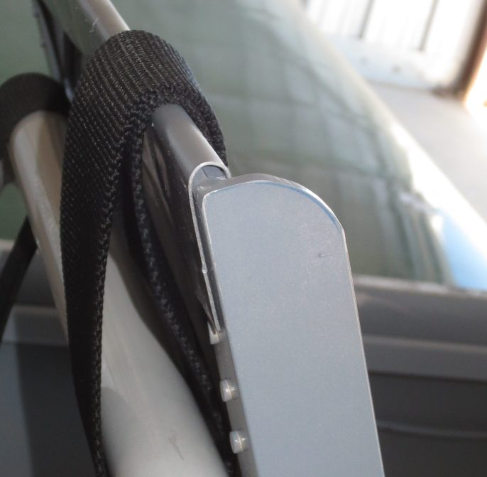

Just got my "Even taller pilot mod" installed. Is very close to what Chaskuss did above. The desire was to lift up the shoulder straps so that tightening them down didn't press me into the seat and stress my lower back.
The main difference is that instead of having a angle stiffener at the top I put in two 1/8" bars rounded over, then bent a 0.25 sheet over that and double flush rivetted. The goal being to not have any sharp corners to chafe the shoulder belts.
Tighten the straps as hard as I can and it just pulls me back, not pushes me down. Quite a bit more comfortable and hopefully do less spinal damage in a crash.
