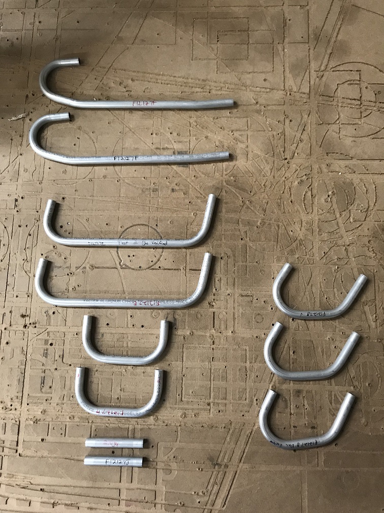

Here is a sneak peak of the first few of the initial pre production prototype tubes.
I spent a couple of days at Steve's shop last week to work on a few things as well as this project. He has spent considerable time and resources to prototype these tubes. Similar to what we did on the RV14 tubes. The investment of the time and resources will make a better product for all of you RV12IS builders. AND save you quite a bit of work. There are a couple of longer tubes in this fuselage that we havent done yet--thinking of several options for it. One of the things we are thinking about is shipping a long, precisely bent tube in a pretty big box. That in itself is expensive!

Van's has finally begun shipping Engine kits and we have now been able to do fit verification tests on our CNC bent Rigid Tube kit for the RV-12iS.
AS Flightlines has decided to offer the F12127E, F, G, H, J, and K lines. They will come pre bent and pre flared. The cost of the kit is $324.95, and we will be happy to buy back the unused AN Nuts and Sleeves from customers for $25 that won't be needed if you purchase this package.
In addition, we will offer the F12127B and F12127C lines for those customers that have not yet completed the bottom skin installation in Section 21. These tubes need to be slid through the bulkhead into place and then flared by the customer due to going through a grommet. The only way to offer these lines pre bent is to install them at this point in the build. These tubes will add $75 to the cost of the above package.
Below are some pictures of the pre bent tubes as well as what they look like once installed.

That's the plumbing for the fuel-injected 12? Am I looking at that right - its behind the rear baggage bulkhead? I think I'll stick with my Bing 64's...
Jim,
That's correct! It's quite an interesting setup. But it was fun to prototype and CNC bend all those little tubes.
We will wait and see if people start to order the "new" rv-12 with the ULS engine. If so, we will start to work on rigid tubes for that setup also.
Steve
Yes it is.....

How do you access all this fuel plumbing behind the rear baggage bulkhead once the airplane is final assembled and put into service?
Also, It looks like several short rubber hoses in/out of the high pressure fuel pumps - what is lifespan of rubber? 5 year replacement again?
Jim----those 2 short pieces of hose are part of the Rotax supplied fuel pumps. They connect the tubes to the stub ends on the fuel pumps. With out changing the design of the pumps to have an AN Male on them, that was the only way Rotax could connect the tubes. I'd imagine getting a pump of sufficient fuel pressure with male AN fittings AND fit into the allotted space might be troublesome.
So yes, there are short hoses, most likely automotive fuel injection hose. Dont think that Rotax has specified --yet---what that replacement cycle will be. Maybe by then there will be a conversion.
