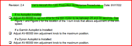

AFAIR there is a note in the PAP that with Garmin avionics and autopilot, the trim speed potentiometer on the back of the AV6000 needs to be turned all the way up for the avionics to recognise the trim command.

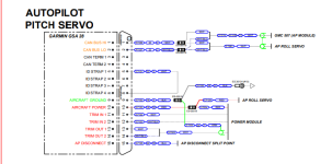

Right then you will have to bypass the connectors on the servo system. Garmin sell a little D Sub connector that will do this for you or you can make your own.
Presumably you have the harness that is future proofed to accept an autopilot ie it has the wiring already there.
Give ma a day or two and I'll try to find out the pin connections for this, and or the Garmin part number. I have a email somewhere from Vans as I also had this issue.

Check that the WH-P30-1 9-pin D-Sub connector is populated correctly. This is the 9-pin connector that is plugged in the back of the AV-60000 Power Module.
The "trim motor power wires" from the 5-conductor tailcone wire, which are either both white or could be black and white wires (not ORG, GRN or BLU) must be installed in pin 1 and 2 in the 9-pin connector when NOT using the autopilot. Refer to KAI 42MiS/U-12, Figure 2.

The trim speed potentiometer on the Power Module will affect the speed of the trim motor in this case. Refer to the PAP pages G1-1 & G1-3.

From Eric at Vans
Sterling and I were discussing your dilemma, the missing plan instructions and alternative ways to solve it.
He came up with a good idea that would alleviate any pin changes if you (or a future buyer) ever decided to add autopilot servos. You could make a Dsub at the AP Pitch Servo connector back where it would plug in to the servo to jumper those wires. You’d jumper Trim In 1 to Trim Out 1 and Trim In 2 to Trim Out 2. If you want to add the AP Servos down the road, you’d just remove that jumper Dsub and plug in the pitch servo Dsub.
Or buy Garmin part No 011 03158 00 Which does the same.
