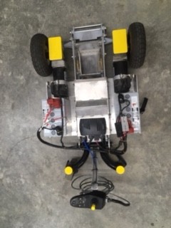

I wanted an electric tug for my -10 and did all the research and ended up with nothing. The problem is the wheel fairing not leaving enough room. Ones that work for the Cirrus don?t work for us. The one that is hard to steer is not an issue for some, but I need to do 90 and 30 degree turns. The track models are out because of the cost.
All my searching inspired a neighbor with a -6A to try and develop his own. With a used $190 wheelchair, some big scrap aluminum channel from a boat project, scrap metal, some small wheels, a bunch of welding, hardware store bolts and a lot of head scratching and rebuilding the result is amazing.
The stearing comrtol from the chair (a stick and speed control) is held in your hand. The two drive wheels and the caster wheels from the chair let it do a 360, the wheels steer by varying their speed, even turning in different directions in a tight turn. There is a platform with a wheel capture mechanism. You drive up to the nose, line up the platform, drive it under the wheel and drive away. The chair control has variable speed and is faster than you want. It easily turns as tightly as the nosewheel allows. Get it to your destination and push a button added to the controls to release the plane and backup the tug.
The only issue with it is going over obstacles, the platform is about 1/2 inch off the ground. His plane has the standard nose wheel fairing.
Would include photos if it were easier. I am keeping an eye on Craigslist for cheap working chairs.

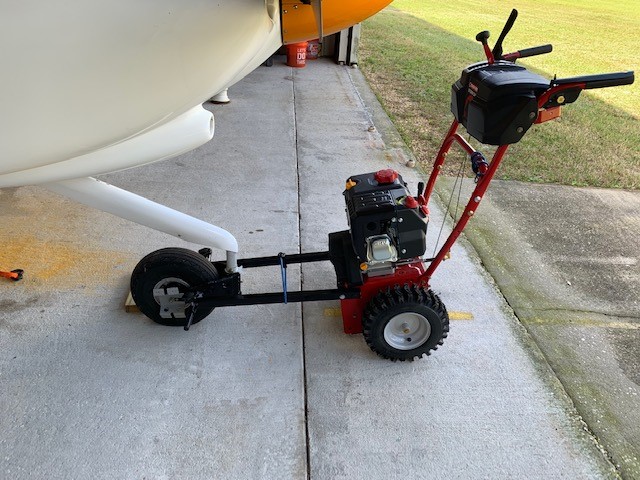

Snow-Blower Tug - Cheaper option that works
This was posted a while back http://www.vansairforce.com/community/showthread.php?t=108484&highlight=snow+blower+tug and I decided that I needed to have one of these. I have my 10 on an incline located on a grass strip. It is Impossible to push up hill without help. I got tired of using the HF winch, it was taking to much time, besides the fact that I had to use a car battery to provide power. Any way here is my solution, using the reference above. My total cost was < $500. And it WORKS !!!
I bought the Troy-built at home depot on sale for $384.24 (including Fl tax)
https://www.homedepot.com/p/Troy-Bilt-24-in-208-cc-Two-Stage-Gas-Snow-Blower-with-Electric-Start-Self-Propelled-Storm-2410/305562533
Hope this helps
