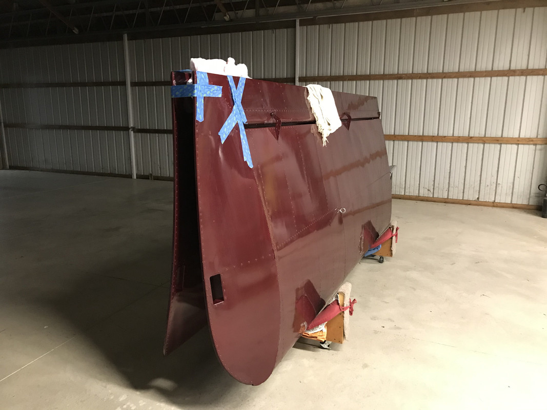

EAA wing stand works well for RV-12 wings:
I used a stout sawhorse to hold the two spar tang ends and two stand-alone carpet sling fixtures (one for each wing) to support each wing out near its tip. The only downside of this arrangement is that it is not on wheels and cannot be rolled around the shop as a unit. On the plus side, when your project is done you have a nice sawhorse for general shop use and a pair of easily stored carpet slings fixtures that can hold one wing at a time if needed.
Wing Cradle
Since the subject of wing storage and construction is up I thought I would share some pics of the stand I built. I'm just finishing up the wing kit now. I made some modifications to the standard EAA cart, extending the length and adding 2x4 supports at each end. This allowed me to use the cart to hold the spars on each side while doing a lot of the skeleton. Once I had the wing skinned up I replaced the 2x4 at one end with carpet material. I intend to keep this cradle around in the hanger to hold the wings and expect it to be a little more stable with the spar ends supported.
A few pics here showing the flexibility of this configuration.

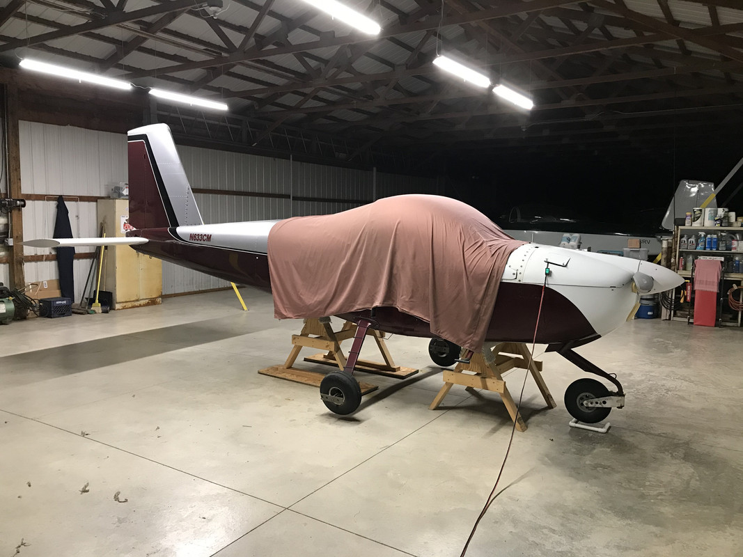

There will be times throughout the life of the airplane when you will want to remove wings to comply with Annual Condition Inspection or to facilitate maintenance.
Ask me how many times I've had the wings off...
