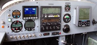

Heres a couple of photos of before and after of a minor panel upgrade, yes, its currently set up to drive from the right seat.
The before photo is not very good but the centre console hid an Expbus 2.
I'm 6ft and around 180lb, it prevented me getting full lateral stick.
The whole centre console is quite useful but does cramp the seats slightly, the vertical part does (just) allow me to get full stick.
It also makes access under the panel difficult, I can't get both shoulders easily past.
If I were to do it again I would leave out the vertical part, and probably the horizontal part as well.
You could also consider putting the fresh air vent in the panel - it works better there and gives more leg room.

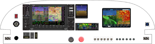

I have the same issue. This -6a was built in 1993, not sure when the EI oil & fuel guages were added. However...I'm now doing a full glass upgrade. The EI instruments are gone and the throttle and mixture knobs will move up to the panel. I included the draft panel layout to show the knob location. Also I'm 6'1, no way to get full stick deflection with two adults.
I'll add in another comment.
