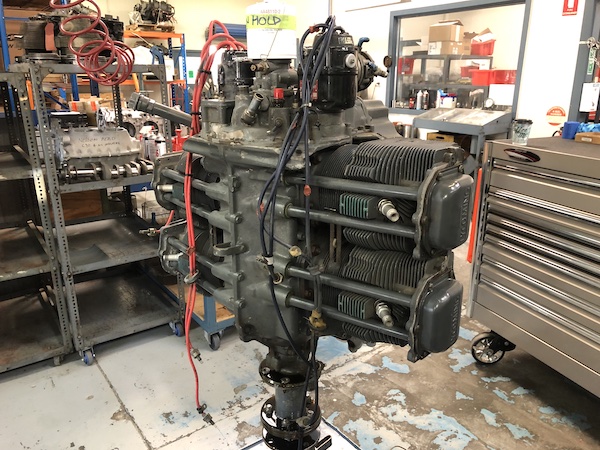

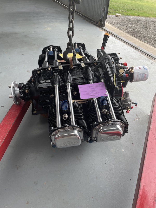

VH-SOL's engine is (was) an O-320-D2A.
It's the 21st century, and carburettor icing shouldn't be a flight risk anymore, so I didn't want to re-fit it to the aircraft without fuel injection. A Precision Airmotive EX320-2 FCU kit (includes flow divider and lines) was acquired.
I also didn't have a huge desire for an ignition system designed in 1905, so I selected P-Mags. For risk amelioration I wanted them from separate manufacturing batches, so I bought them both separately several months apart.
I bulk-stripped the engine myself in the Riverina Airmotive workshop in Parafield, South Australia, in mid February 2021. The crank went off to Aircraft Specialties in Tulsa for machining to M003, the cylinders (which only had a thousand hours on them) were reconditioned, new camshaft, new oil pump, high pressure fuel pump. One of the rods showed up with a manufacturing defect when it was NDT'ed, so that got replaced.
Riverina Airmotive rebuilt the engine and sent it back to me in late May, zero time and good to go.

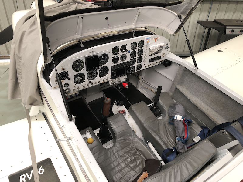

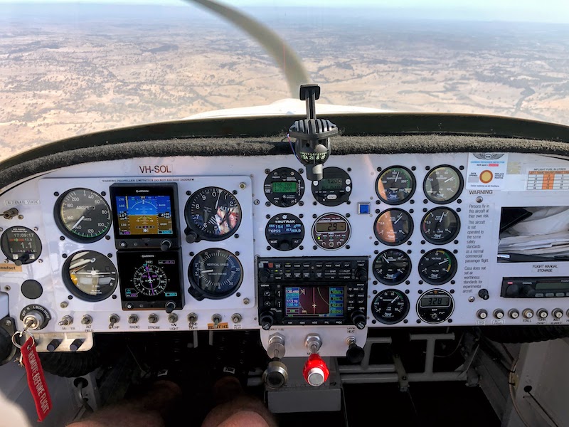

Over my years of ownership, I'd progressively improved what I started with. The panel had two Garmin G5's with a GMU11 in the starboard wing, an MGL INFO-1 g-meter, a Garmin GNS430W, a Garmin GMA340 audio panel, a GAD29 to connect the GNS to the G5 system, a TruTrak 385 autopilot, and a Trig TT21 ADS-B-Out transponder.
It also had a UHF transceiver connected to COM3 on the GMA340 via a CRI-1 "commercial radio interface," and a lighting bus.
Here's what it looked like on the last flight before it all ended up in a pile on the hangar floor:

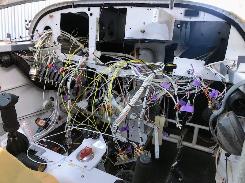

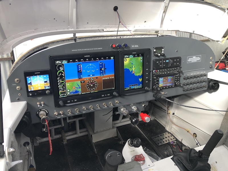

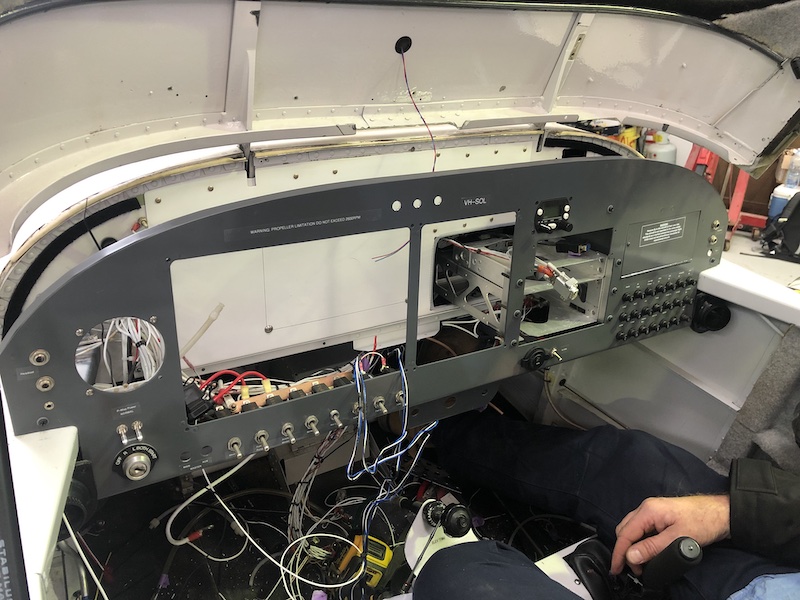

The replacement consisted of a Garmin G3X Touch system. One of the G5's was repurposed as a backup flight instrument. ADHARS and EIS systems were added. GDU460 and GDU470 PFD and MFD displays were provisioned. The GAD29, GMU11, GNS430W and GMA340 were retained. A GDL50R was acquired for ADS-B-In. New Garmin pitch and roll servos and an autopilot controller panel. The Trig TT21 and lighting bus were kept, but repurposed. A GTR20 remote-mount VHF was installed as COM1 (the GNS430W is COM2).
I did system design throughout late 2020 and early 2021, paying particular attention to redundancy and failure modes. An auxiliary power bus was designed into it, which keeps the PFD, EIS and ADHARS running for more than an hour following complete failure of the aircraft's main bus.
The installation was mostly performed by Lyndon Tretheway at Custom Aircraft Centre at YGWA in South Australia, with me doing the odd splice, handing over tools, assisting with design direction or wiring pin assignments, or annoying him with idle chit-chat. I think he gave me odd jobs to do to get me out of the way :)

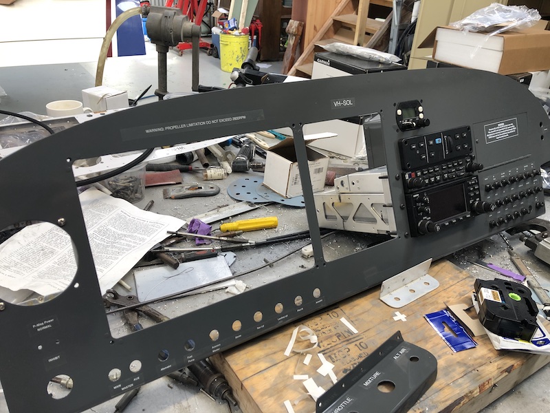

Lyndon fabricated a new panel, using the old one as a cutting template and a component donor.
The old one was removed, with copious wiring strippped-out and discarded. The retained wiring was substantially tidied up.
A patch and stiffener was fabricated to fill-in almost all of the penetrations through the subpanel, substantially improving it.

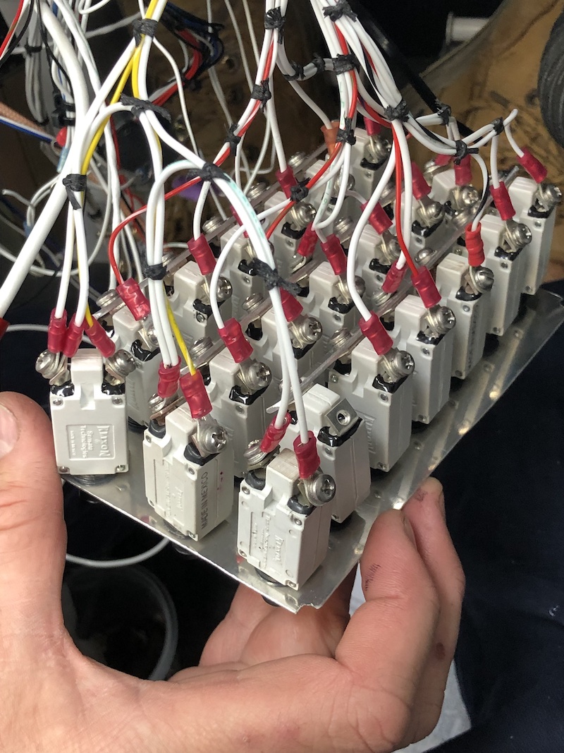

Circuit protection was rebuilt from scratch, using klixon 7277 circuit breakers in a breaker field on the starboard side of the panel, all properly loomed and laced with main bus, avionics bus and auxiliary bus.
Cable looms to all the instrumentation are easily accessible with service loops for maintenance.
.../continued
First power-up was a nail-biting experience which became anticlimactic because, incredibly, everything worked first time. A couple of sensors were off-by-one pin, but other than that the whole system booted up without issue, zero canbus errors. It just ... worked.

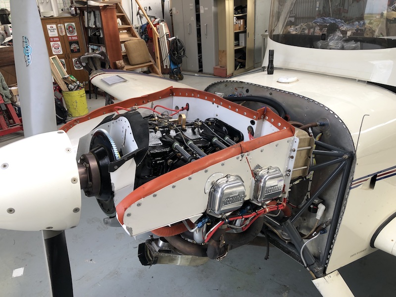

Engine reinstallation

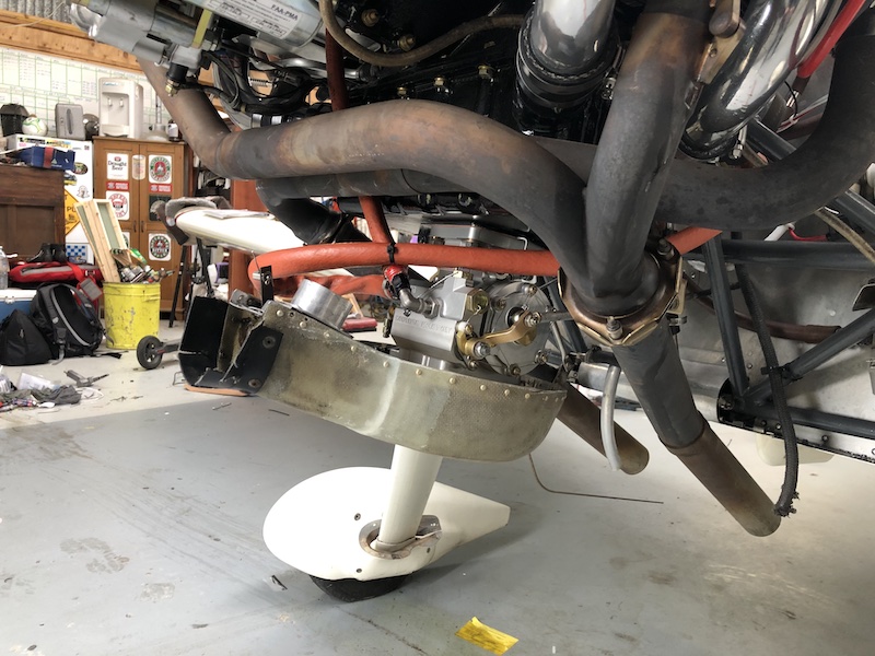

The FAB needed reconstructing due to the dimensional change between the carb and the FCU.
New fuel lines were fabricated.

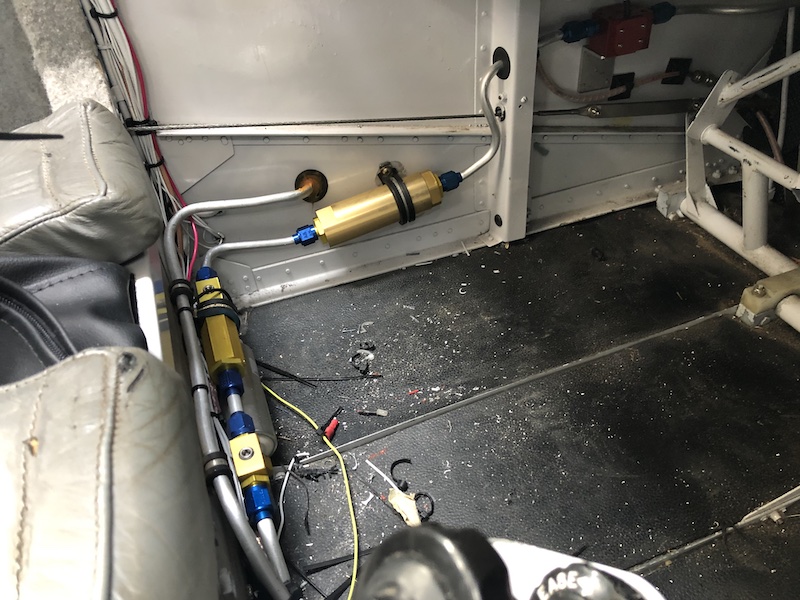

A high pressure electric pump and filter were procured from Vans. The pump is mounted to the spar on the pilot side, the filter is on the port side of the cockpit where the Facet fuel pump used to be. An Andair gascolator/filter is on the firewall. The FT-60 "red cube" is installed using the same mounting hardware as the Electronics International fuel flow transducer it replaces.
100% of the engine wiring was removed and rebuilt better. New wiring for EGT and CHT sensors, dual P-Mags. Pointless splices that'd accumulated over the course of 25 years were removed. Wiring was properly secured, proper aircraft-grade connectors and terminations were used throughout.
Because everything was rebuilt and rationalized with maintainability in mind, there's now a lot more space behind the engine for (eg) removing fuel filters. My first oil change after return-to-service was accomplished without spilling a drop :) It really is a surprisingly pleasing result.

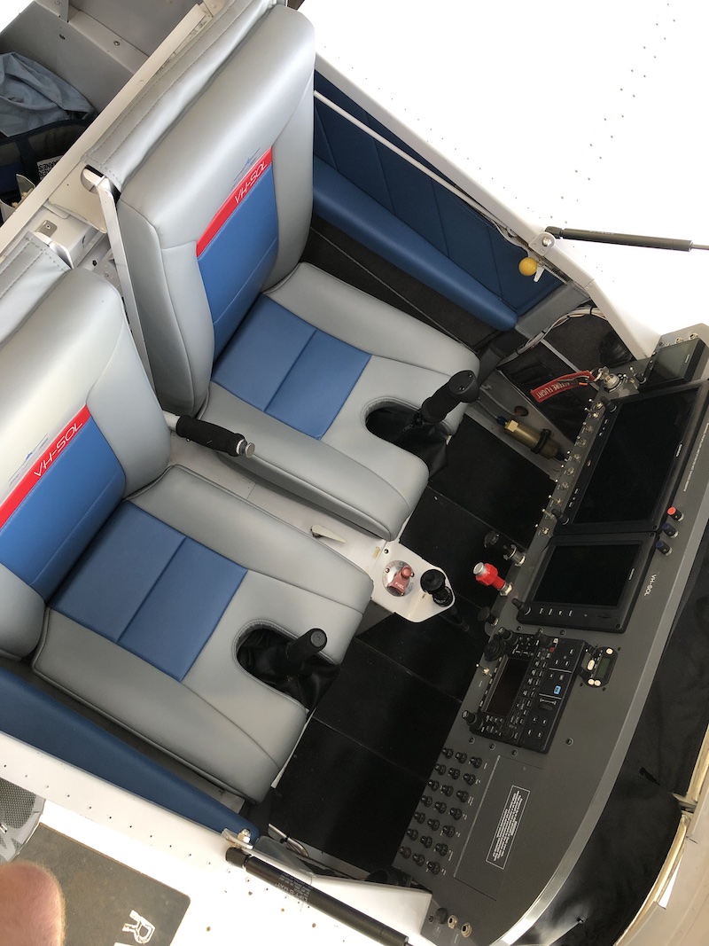

Interior
The seats were getting tired and starting to look ratty. Not exactly a wonderful first impression for an inspired RV-grin inductee.
I ordered a new interior from Classic Aero in December. The color scheme is a grey base to draw on its history, with blue and red highlights to match the airplane's paint. Sportsman seats, upholstered in Ultraleather.
It arrived in June, just in time for Sydney's COVID-lockdown :)
Glenn Bridgland helped me install it in October, and the result is frankly amazing:
There's also a tonneau cover which I haven't installed yet. Waiting for a bad-weather weekend when I'd rather not be flying.

Will you please post photos of your fuel pump mounting along the spar? I see where you put the filter.
Well done.
This pic is during construction, so it's a bit ratty. Shows the general arrangement. I don't think I have one from a better angle, but I can always take another if there's something specific you want to see.
It essentially picked-up the outflow from the existing Andair fuel valve. Needed minimal modification; I think we cut and put a new AN fitting on the hardline that used to feed the Facet pump, and made a new hardline to connect the pump exhaust to the input side of the filter. The filter's outflow picks up the existing line.
Lyndon and I scratched our heads for ages in trepidation about the fuel system modification, but it ended up only taking a few hours. It didn't deserve anywhere near as much stress as I put into it before we started :)
The pump/bypass is pretty much invisible unless you crane your neck to look at it, and it doesn't get kicked when you enter and exit the cockpit, so I think it worked out pretty well.
