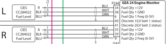

Thisis how the CiES senders are wired to G3X:

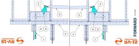

The bell cranks below aren't that interesting in themselves. But the KAIs call for match drilling each of the rivet holes. However, I tried it out and the rivets all fit perfectly without any match drilling required on both parts. Pretty amazing!
I just had an insight as I posted this image above that the mirror image bracket may not be the same - and sure enough it is not.
This is what they should look like from above.
This is the left side build per KAIs - note the elevation of the bracket relative to the hole in the rib. It is correct.
And this is the right side built without thinking through it (and not specified in the KAIs) - this is built and installed incorrectly. Well, that's a new project for this week.
And this is the right side built without thinking through it (and not specified in the KAIs) - obviously incorrect. Well, that's a new project for this week.

I made the same mistake. The inboard bell crank is symmetrical, which tricked me into thinking lazy and assuming the outboard would be too.
Drilling to separate those parts did not go great for me. Long rivets in thick material, it really didn't want to come apart around the bearing. I ended up galling the parts enough that I don't want to use them. $36 each for the bell crank halves if anyone is wondering.

The right side as shown is incorrect. It what it looks like when you build both sides the same. The bushing should have the long section on the bottom, so I have to disassemble the halves and re-do it. (like Nate)
Thanks for sharing Nate. Your pain made me go slowly and carefully, and was able to reuse the parts. Quite an effort, but one step a time.
Here's what they're supposed to look correctly. They are mirror images, not identical parts:
The large part of the bearing is on the bottom side.
