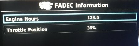

One additional detail…
Even if using 35% throttle position to start a 912iS, the RPM will always exceed 2000-2200. Sometimes it will even exceed the alternator switchover RPM of 2600. Rotax expects this to happen and specifically specifies it for a few seconds to activate the switchover. You are THEN supposed to retard the throttle to keep RPM below 2500 until oil temp reaches 120 F.
Just learned this about the Rotax 912iS display function last week.
With one or both Lanes on and the engine page displayed, pressing the menu button reveals a FADEC Information button. On that display, it shows the throttle position in percentage… which IMO is the factual answer on where the throttle is positioned for engine start.
Here’s a picture.
Fly safe!
-Jim
Here’s a picture.
Fly safe!
-Jim
Not needed for RV-12iS because that same infor is displayed on the EMS portion of the screen beside the tach indication.
