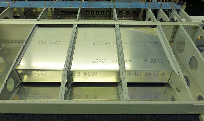

The RV 12 in my opinion is the best low wing light sport aircraft kit on the market.
The removable wings are ok if you are going to keep the aircraft at home and take it to the airport, ( go flying ) and then bring it back home.
There are four or more different wing tank designs that builders are using.
I am sure that vans could come up with the best designed RV12 wings tanks.
I am building my wings last as I was hoping that Vans would come out with wing tanks for the people who don't want to give up the area in the baggage compartment.
From the builders I have talked with this is the one thing that they wish vans would have given a option for wing tanks ( maybe EAB only )
For the builders that I have promised a link to the building of my tanks ( is still in progress ).
http://joesrv12.com/Builder Log/bl_15_08.htm
This in no way is suggesting this is the way to build your wing tanks, this design is not tested and the design is still in progress.
Joe Dallas

Looking good Joe! I am waiting for delivery of the Viking wing tanks, but wish they had more than 20 gallon capacity. Have you calculated the capacity of yours yet?
Doesn't appear to be any provision for removing a tank if there should be a problem. That might be a good feature to have.
Also, consider adding weep holes in the lower corners of the wing cells in the area, just so that if there are any leaks, they'll drain out.

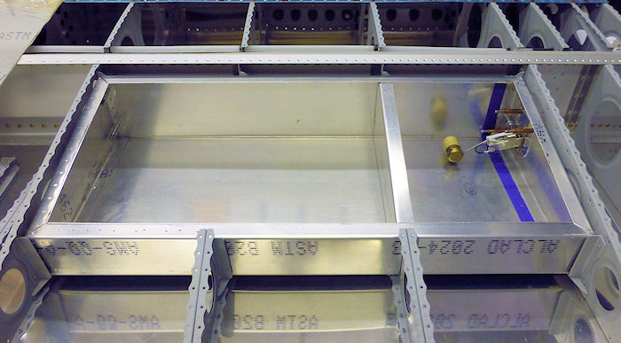

Hi Joe,
Looks like a good installation and nice workmanship, but I have a question.
Did you consider installing baffles in the tank? Both fore and aft, as well as laterally?
If the tank is half full, it looks to me that fuel could slosh fore and aft substantially, not to mention laterally during less than perfectly coordinated banked maneuvers.
The initial test flight would be a very bad time to discover they needed them.
Just a thought.
21 gallons +
Don
Each tank holds 10.5 Gallons and I may add a 3 gal Header tank if I use a fuel injected engine.
Joe Dallas

The baffles are baffling me
Yes I have about four different plans to try to solve that problem I am leaning towards baffles with doors.
Looking for suggestions.
Joe Dallas

work is still in progress
The tank can be removed by removing the top inboard wing skin.
Not that hard but would not be good for the paint job
There will also be a tank drain at the low corner of the tank and a hole in the bottom skin at that location with the bottom of the inboard rib sealed.

Joe,
I have admired your ingenuity. It will be interesting to see what kind of unusable fuel quantity figures your final design generates.
Regards,
Tom
Joe,
I really admire your ingenuity on those wing tanks.
It definitely makes the RV-12 package more attractive, especially if it increases the usable fuel quantity. I think 25 gallons would be close to perfect for that airplane. Not to mention, the increased cargo space.
I never have been crazy about 20 gallons of fuel sitting right behind the right seat and the aft window getting damaged by an inadvertent overfill of the tank.
Good job!
My next airplane could be an RV-12 with wing tanks.:)
