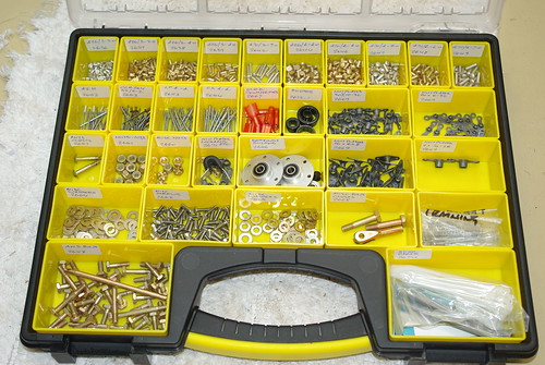

Fasteners storage
FWIW, this type of storage box works really well for rivets, AN bolts, bearings and all the other stuff that comes in those little brown paper and plastic bags. Each compartment is labelled with the part ID and the original bag number, as there will be times when you want to check some parts against the inventory and then you need to know which bag it came in.
The compartments are removable and can be arranged any way you like, and taken out to sit on the workbench when you need them. Although everybody will have their own solution for parts storage, this box is compact and contains ALL the small parts that came with the empenage kit.
Although it's not shown here, I also sorted and strung each different type of washer on a short length of thin plastic-coated garden tie wire with its own label and stored them in a couple of the compartments. Bolt sizes were written on the bolt head or shank with a Sharpie pen.
Nice storage box for the hardware.
Could you please indicate the brand and model number for us. It's probably available via internet.

It's a `Stanley' item. Has H-1200130-E stamped on the lid and Art.No. 14325 on the underside of the box. Sontax make a copy, but it's not as good. I've also got a stack of fixed-compartment tackle boxes, but it's the modular removable containers in this one that make it a winner.
If you can find them, get 3 or 4 so you can mix/match containers. I got two (about $18 ea.) from your equivalent of Harbour Freight here in Australia, and when I went back recently to get a couple more, they'd sold out. Always happens!
Good luck with your build.
