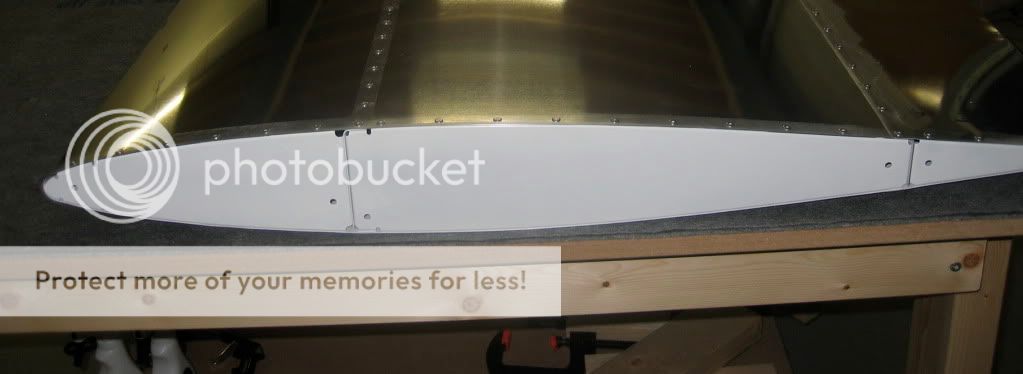

My first mod? In preparation for paint I decided to make covers for the stabilator. I think it cleaned up the ends real nice and gave them a finished look.
If someone would post a "before" picture I would apprciate it. I took one, but it did not turn out.

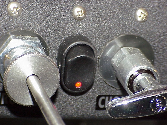

I decided I wanted to be able to turn off the fuel pump without pulling the fuse every time. IMHO the fuse holder is not designed to have the fuse inserted and removed constantly and could eventually become weak or break from constant flexing. Anyway, I decided to add a nice little LED rocker switch in the area that has the auto pilot disconnect. It looks pretty good and almost like it came from the factory.
Down side? I'll need to recalculate the "K" factor if I choose to have the pump off most of the time inflight. I plan on only using the boost pump 1,000' AGL or less.
All I need is a label and it should be good to go.
