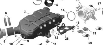

But I’m still looking for input from someone who has replaced their airbox connecting hoses and can share how they accessed the nut holding it down? It’s really buried under harnesses and the engine mount.
