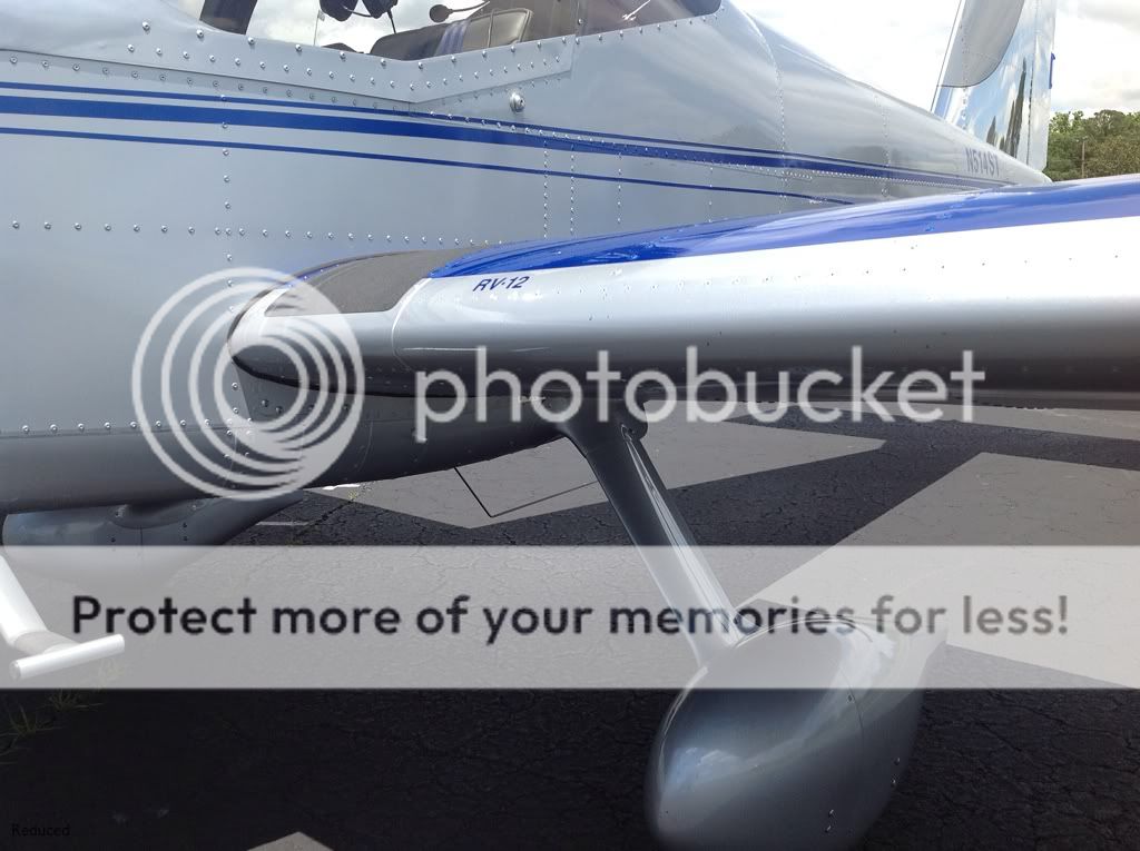

Finished the gear leg fairings and flew for the first time today. Also added the nose leg fairing. My best guess is a 2 to 3 knot speed increase at 4900 - 5000 rpm at 2000' altitude and temps in the 70's. Very pleased with this mod. Used the Van's RV-8 flat style gear leg fairing and the RV Bits close out fairings (Cleaveland Tools). Thanks to Dave for posting his pictures. I'll try and post one of mine.

Is it possible to measure width perhaps, and be sure which end you cut off? I am seeing advantages of wacking off either end, but am not sure just what is best. How much did you allow the leg fairing to go into the wheel pant and fuse fairings? Any guidance of what not to do?
I think 17 in from the bottom side to fit my fairings. I have top gear fairings from South Africa (RV Bits). No issues after the SB on the gear legs.
I cut from both ends and left about 1 1/4 - 1 1/2 inchs to fit in the upper and lower fairings. Sorry I don't remember much more.

The paint is PPG Urethane base coat/clear coat. The light color is PPG metallic "Silver Blue" and the dark color is PPG metallic "Long Beach Blue". A note about the gear leg fairings: Out of the box, the gear leg fairings are wider at the top so I decided to trim my main gear fairings from the bottom. This was a good choice for me as it provided more room and better clearance between the piano hinge and brake line aft of the gear leg.
