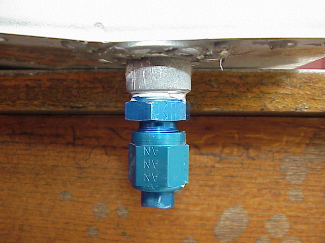

NOT HAPPY!!!! The tank is complete here, at least I thought so, and leak free. This is a simple thread mate issue. SEND US a modifed strainer that will mate with the flange!!!! NOT a new flange. May have to send the entire tank back to Van's and let them modify it.
Well, I gave it a try with a 3/8"x18 NPT Pipe thread tap. I used a Channel Lock pliers (water pump pliers) built for pipe to hold the boss while I ran the tap about 3/4 ths the way in, worked great. Very little side pressure on the boss so I'm sure the seal is good. I packed the flutes of the tap with grease to try and catch as much of the chips as I could. All I need to do now is clean the tank out by flushing it with fuel a couple of times. I'll filter the gas with cheese cloth and put it back in the gas can.
If you have already sealed your tank the boss can be tapped out without damaging the tank. Make sure you are using a sharp (new) tap. Don't use the one that has been bouncing around in your tool box for 10 years.....like mine. A tap this size can be sharpened on the grinder if you are careful, but a new tap will work better.
Larry- I tried the same thing with a NEW 3/8-18 NPT tap , and all I got out of it was another half turn into the VA-210! That makes a total of 1 1/2 turns in- not nearly enough! The VA-261 should thread in about 3 to 4 turns. Luckily, unlike Marty and yourself, I had not yet installed the VA-210 in the tank bottom. It was at that point that I called VANS, and I guess, inadvertantly, initiated the recall process. Steve
You need to run the tap about 3/4's of the way in to the boss. The threads in the boss are NPT (National Pipe Threads) and are tampered. The threads need to be cut deeper. Back the tap up every 1/4 turn to break the chips, and load the tap with grease to minimize chips in the tank. Try it again, I know you are going to get a new one, but this is a good time to experiment for those who have built the tanks already.
Here is a picture of mine. When I started there were only 2 threads contacting the boss, now it is about 3/4 the way in per specs. The gripping tool did leave a mark on the boss, but if you are careful you could do it without a mark. I got a little carried away with gripping the boss to protect the tank skin. BTW the tank is full of 19.6 gallons of fuel to test the boss. The tank is sound and no leaks.
