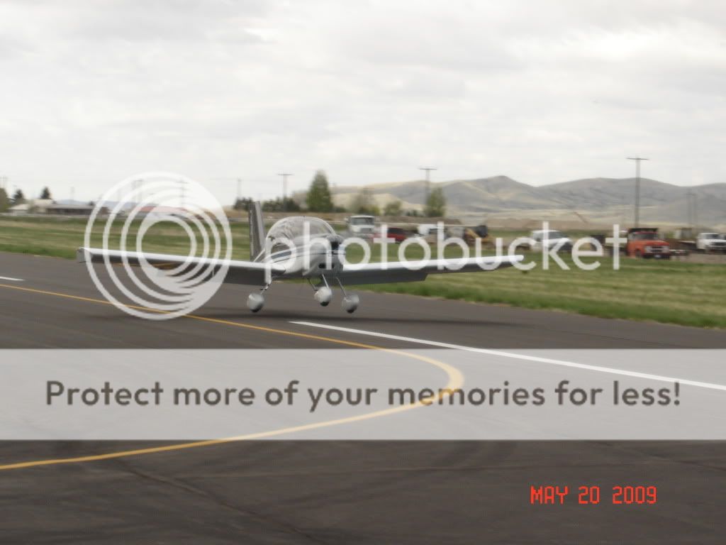

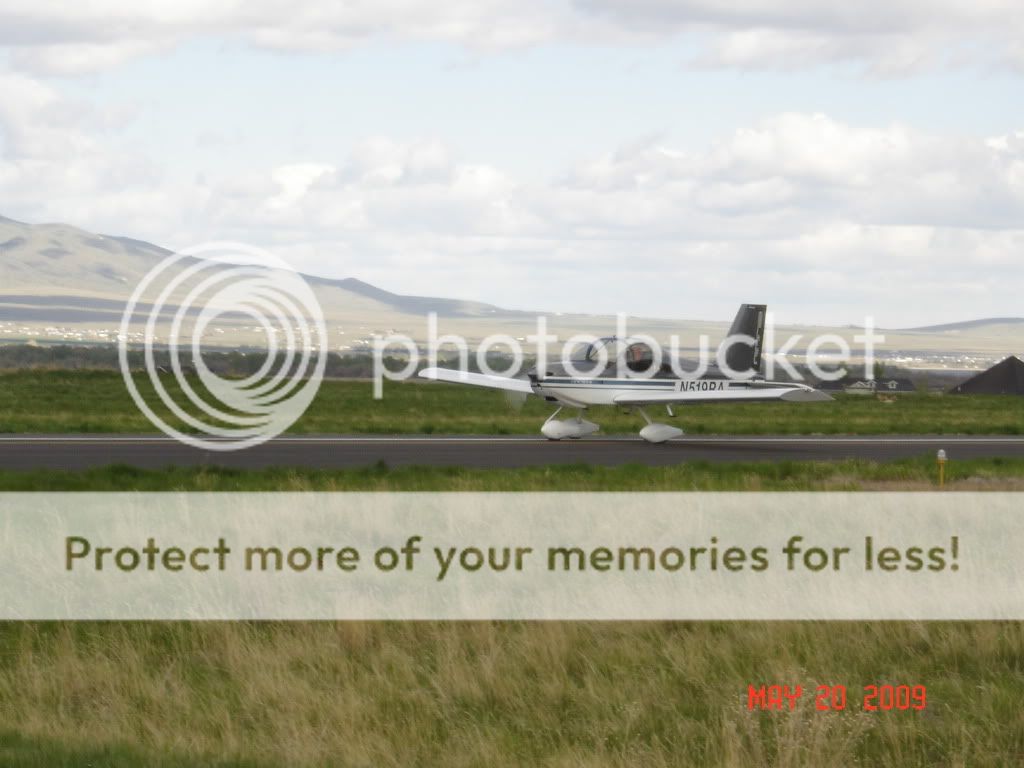

Here is a look at Vans competitor the S-19.
The 1st(non prototype) S-19 to roll off out of the Rans factory touched down in Townsend today.
Here it is looking good on back taxi.
