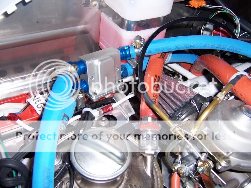

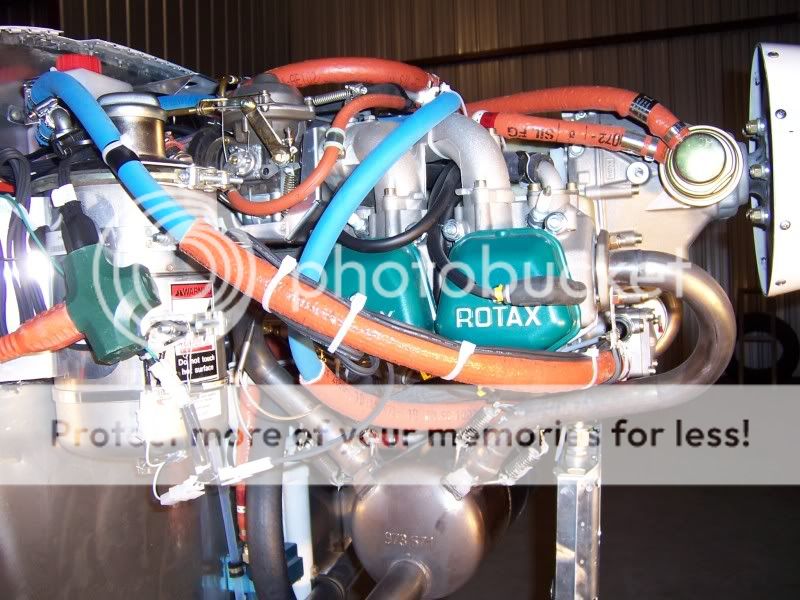

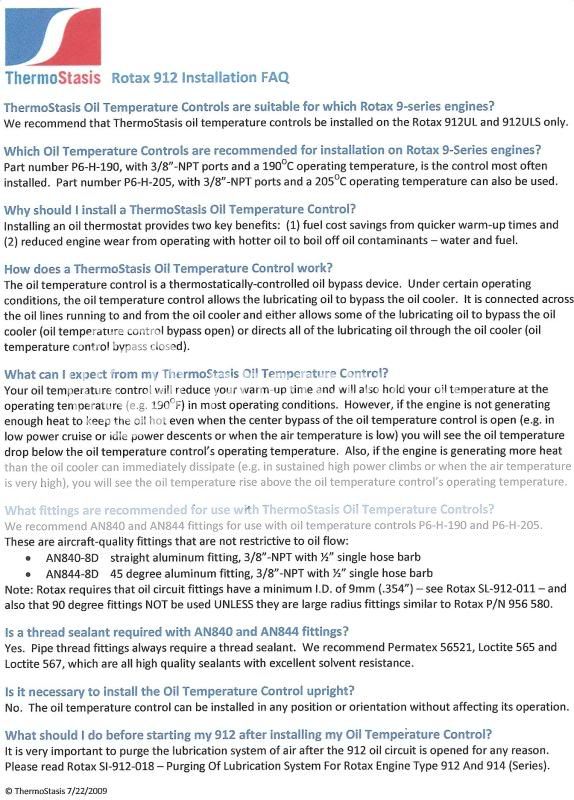

Oil Thermostat?
OK Larry, I was dozing again...tell me about the 'oil thermostat'.
thanks
Meade and George
#16
How to - - - -
98% by-pass. Works great. Saves warmup time, and gas ! In colder climates, worth doing.
