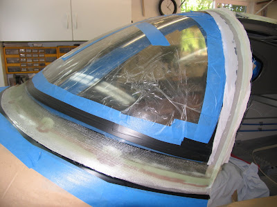

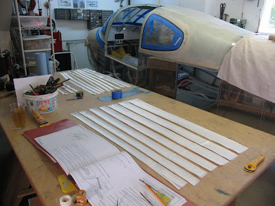

I have Weld-On'd the windshield to the cabin top and am about ready to lay the fiberglass for the lower windshield fairing. I've not done much glassing at all and was wondering if any other builders have advice on setting up and executing the layup process.
Do I prep "wet" the strips elsewhere and then lay them in, or lay the glass on the seam and wet it with a brush?
I have a slower West Marine epoxy hardener since I was working last in the heat of summer, is this OK for the layup?
Any other technique advice for this process?
I would suggest you read a couple of the EAA tips on glassing if uncomfortable with the glassing.
For mine I cut out all the plys of cloth. Wet glassed the cloth on the work bench covered with a plastic sheet, one at a time.
Laid each layer in place and smoothed with a brush or squeegee.
After the glass layers have set, you will still have to build up the shape will epoxy filled with glass balloons to get the shape right.
I used the west system and the slower cure hardener for all the work, it will just take a little longer to cure at lower temps. The plus if this task is a longer time to add each layer.

Eric hit it pretty well. My Prop-jet buddy showed me the way Lancair taught glassing and I liked it so much that I abandoned the messy methods I used with model gliders. Basically you do it like Eric said. Cut your fiberglass and lay it over plastic sheet. Then, mix your epoxy and pour it over the glass (it takes some practice to get good at how much to use but it's easy to make corrections) and then cover with another plastic sheet ( you can get blue plastic in rolls like you can the fiberglass). Use a hand roller over the second sheet to force the epoxy into the glass and spread it around; roll any excess off to the side. If you've used oversized plastic sheet, the excess stays on the sheet instead of oozing onto the workbench. Once the glass has been thoroughly wetted an the excess pushed to the side, you will essentially have a sandwich; take a rolling cutter (available from ACS) and trim the plastic around the fiberglass piece. You can now lay the glass aside, toss the excess plastic and epoxy and clean up the little bit of ooze from the workbench.
For the actual layup, take a brush and wet the area where the glass will go with epoxy (you already scuffed it and cleaned with acetone, right?). Peel the plastic on the downside of the glass and lay the part in place. Then peel the top side, using your fingers ahead of the plastic to push the glass down well. Go back over it with a brush and work out bubbles (and even reposition it slightly) using a stippling motion. Trying to use a brushing motion will only drag the glass around.
When the last part is in place, you can use peel ply over the whole to help soak up any remaining excess epoxy and give your layup a finish with some 'tooth'. If you've never used peel ply before, you'll be amazed. When the epoxy has set, you just take an end and pull it away. "Riiiiip!" You feel like you'll be destroying everything you just did but it comes away just fine and leaves a nice surface for filling, final sanding, and painting.
Eric mentioned using epoxy with glass micro-balloons ('micro') for filler. You can also use flox (glass fibers) to create a filler that I prefer for larger depressions. I have used flox before using the peel ply and ended up with parts that required very little filling afterward; just be careful not to push the flox around as you apply the peel ply.
It sounds like more work than it really is and, if you don't rush yourself, it can be done without making much of a mess at all. Taking the time to clean up as you go really pays off.

A couple of additional things-----
Peal ply is for when you are doing an additional layup after the first one sets. You peal ply the wet epoxy and forget it until the next layup is ready, then remove the peal ply and go to it.
This is a ten ply layup, do all of them at the same session. Peal ply is not needed, but you can use it on top of the last layer help to make it easier to smooth out.
As I recall, the plans show a 7" radius for the layup, make a template for this, dont expect it to be exact, it will be close in the center, and not at the sides of the windshield.

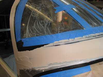

The interface of the windshield and the top cowl makes a big step----mix up some flox and blend this in before you start laying glass.

The unprofessional way
It seems there is more than one way to do this.
Here is what I did and I am not trying to talk you out of doing it the right way.
Do all the prep as is suggested for the lay up.
Prepare all the fiberglass strips as described in the plans.
I cut mine in half and have them overlap 6 inches in the center.
Brush epoxy on the intersection between window and fuse and apply fiberglass,stipple with a brush ensuring that glass is fully wet and lay up the next and on and on until all the layers are installed.
Takes about an hour and no helper needed.
I don't think fiberglass knows whether it gets wetted on a table or on an airplane.
There will be no epoxy on anything except where it belongs.
I never use more than 2 pumpstrokes of the west system slow cure epoxy to ensure the mix is fresh and wets out nicely.
The only downside I see to this method is perhaps a bit of oversaturation, but most of the excess epoxy will be soaked up by the subsequent layer.
I have learned this from other builders who like me have put on hundreds of hours on their airplanes that show no signs of an inferior windshield intersection fairing.

OK, I filled the gap between the lexan and the cowling with thickened West Marine resin. The next day I laid the various layer in place, smallest to widest. It seems that the width of the last strip does not cover all the previous ones, given that it is supposed to abut the electrical tape. I also noticed that there is not the most graceful curve to the fairing so I mixed up some more thick resin and hand applied it. I'll have to do something else along the sides near where it meets the cabin top since the layup does not fill that gap fully. Guess it'll be some wonderfil there... Now for sanding and sanding.

OK, I filled the gap between the lexan and the cowling with thickened West Marine resin. The next day I laid the various layer in place, -------
I would have done it all in one session, not let the filler cure first. Better adhesion for the cloth layup that way.

using many of the suggestions in this thread i did the fairing lay up today.
I used black dye. I did all 10 layers in one session immediately after filling the gap between the bottom of the windscreen and the fuselage with micro ballons.
I used peel ply to finish off the job.
