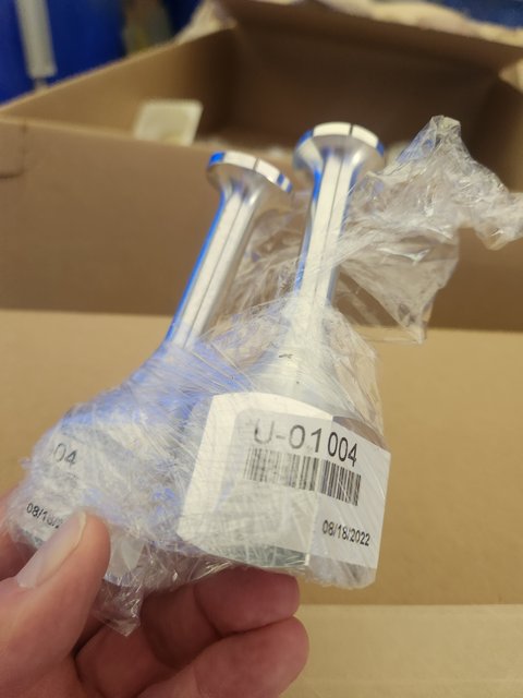

For you RV-10 builders (and owners), Van’s took action to address the poor axle extension design that supports the outboard side of the wheel pant. This extension tended to break.
Here is the very nice machined part that came in my finish kit (now $77.50 each instead of the original $8 axle nut).
However, I do not use the Van’s wheel pants on my original RV-10 nor on my current build. I use the James wheel pant as it is much narrower profile.
My buddy Tom Doran says he can mill some hex stock for me to make the original axle nut. That is plan A. Plan B is to cut these down to fit (but I hate to ruin such nice work).
Bottom line - if you are planning on main gear wheel pants other that the wide body Van’s part you will need to address this.
