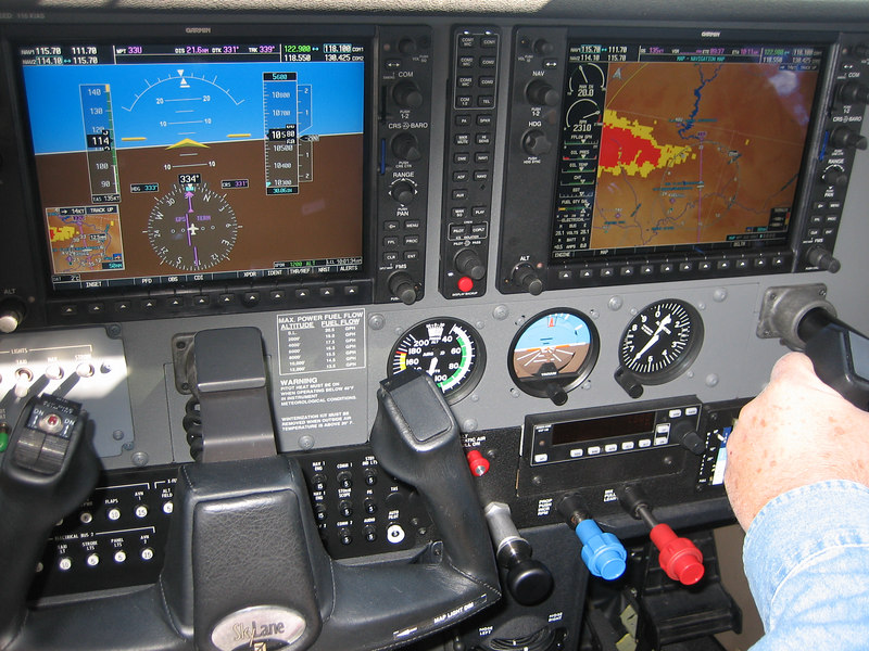

Hi Brian, I love the 182 but it is a different plane then the RV-10. I flew this 182 from time to time while I was building the RV-10.
In the second picture you can see I have the RPM at 2310 and 20 inches, the TAS is 135 knots at 10,500ft and three people. The RV-10 would be at 165-168 knots TAS with the same settings. As for room, the RV-10 has more room in the back.
