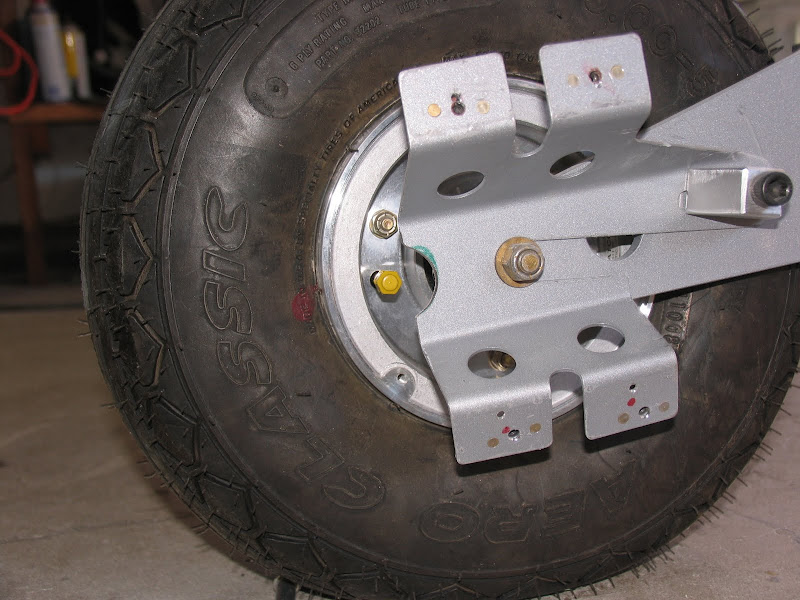

How do you access the main tire valve without removing the wheel pants?
The way the valve stem protrudes toward the axle nut it is difficult even with the wheel pants off. I need a finger to pull the stem outward and an angled chuck to inflate.
The nose wheel is much like the RV-8 main wheel, the valve is sticking straight out and easy to acces through a 1" hole in the wheel pant.
IMG_1507.JP
(Nose Wheel)
The bracket on your nose wheel. What brand is it! Thank you. Rv 10 519pj

I too use the measurement from the floor to the center of the axle ext screw. However, I can check with the wheel pants on as well. I enlarged the hole to 2” and use a sheet metal plastic cap cover. I made a tool to pull the valve stem away to check pressure or inflate. Still a PIA.

The wheel pants on my 10 have spring loaded doors. You just push them in to access the valve stem. My tubes are the leak guard type and have an 87 degree valve. I also mark the inside of the tire with a white stripe. When it is pointed straight down I know the valve stem in under the door. I do use a valve extension as it makes it super easy.

As mentioned, get the Dresser tubes with the 90 degree valve for the mains. Drill a hole in the wheel pants to access the valve. I positioned the valve (wheel mounted wheel pant off) and shot a laser light onto the positioned valve. Then installed the main wheel pant and drilled the hole where the beam hit. Get a metal cap from Home Depot. Also buy a motorhome tire valve extender 6 inches long. I have a small piece of tube that slides over the valve extender and also slides over the valve cap for easy removal and install of the cap. You line up the valve with the pant hole, remove the cap, screw on the extender, add your air and remove the extender. The front tire, just remove the wheel pant.
Installed the Vans supplied straight valve tubes and they come really close to the axle nut. Looking at replacing the tubes with a 90 degree valve. I see Desser has a $60 experimental tube or a $150 tube. Anyone know the difference besides the price?
