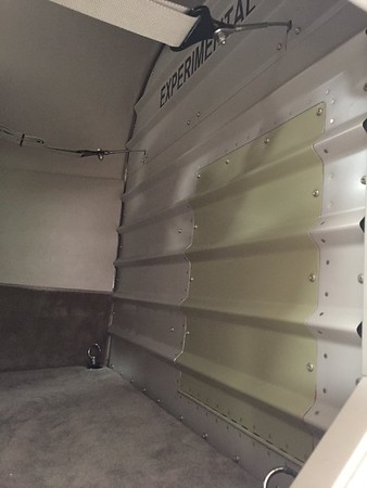

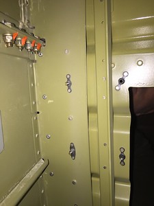

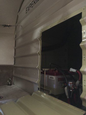

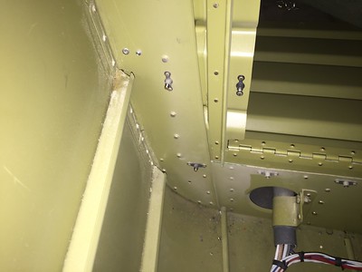

3. Installed an access door in aft bulkhead- Now just 10 screws instead of 35 to check the battery and aft equipment bay.

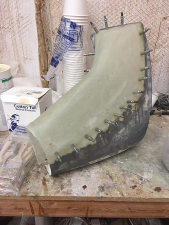

4. Enlarged oil cooler inlet and ducting

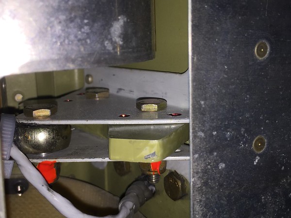

2. Reduced my aux battery system by half- saved about 8 lbs.
![i-dzgqHff-M.jpg](/proxy.php?image=https%3A%2F%2Fphotos.smugmug.com%2Fphotos%2Fi-dzgqHff%2F0%2Fcd367f91%2FM%2Fi-dzgqHff-M.jpg&hash=368fa99fec93168c822fbb09de126533)
![i-FtppJLk-M.jpg](/proxy.php?image=https%3A%2F%2Fphotos.smugmug.com%2Fphotos%2Fi-FtppJLk%2F0%2Fa7fb4dd5%2FM%2Fi-FtppJLk-M.jpg&hash=bb6e24f4ccfde77a5b4243af08b7764b)

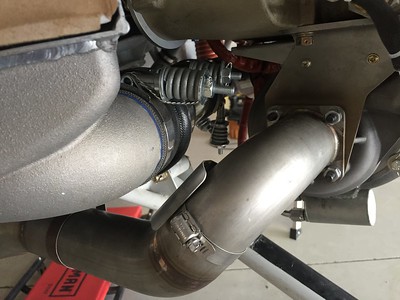

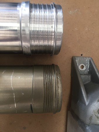

![i-BNdZ5zn-M.jpg](/proxy.php?image=https%3A%2F%2Fphotos.smugmug.com%2Fphotos%2Fi-BNdZ5zn%2F0%2F149d3dbd%2FM%2Fi-BNdZ5zn-M.jpg&hash=ed994a8d001db6cb6bcd06399c1db7b6)
5. CMI installed a production version oil pump -- This was a huge disassembly job that is half of the reason for the lengthy condition. Checking to see if I can post photos.- standby.
