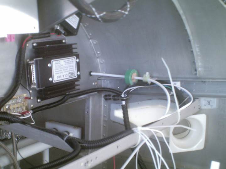

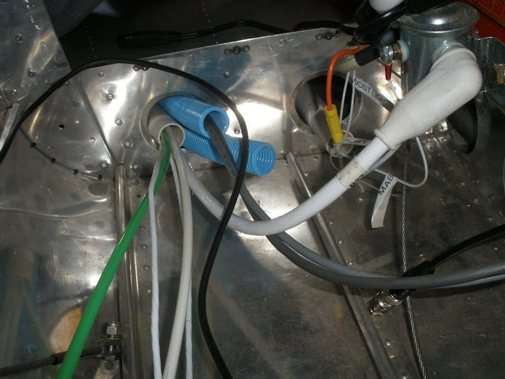

I dont have any photos of the actual static port installation, but the line is hooked to a "T" and a leg is run forward through the white plastic tubing shown here. Static is the white line, and Pitot is the green one---I have to run pitot back to the AHRS, thus both lines are in the tailcone. This shot is early in the process, sorry for the mess.

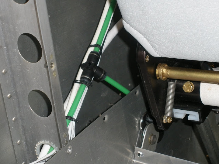

Here is where I installed a "T" in the pitot line, so it could be run forward, and back to the AHRS. Little cleaner installation :rolleyes: This is just behind the pilot seat.

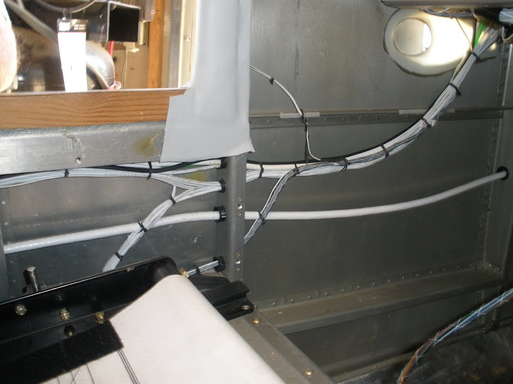

Just in front of the pilot seat, still going forward. The static tube is bundled with the wires, so is a bit hard to see.

Can you tell me where I could find some of those white grommets you used in the lighting holes? I would love to buy some of those:D
