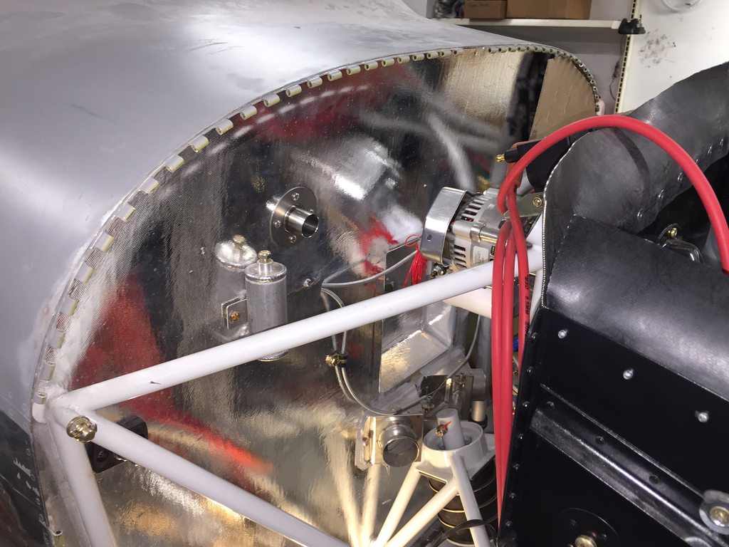

Ed,
It looks like you installed the heat shield mat underneath all bolted items through the firewall, including the engine mount? Or is the mat cut out in all those areas?
Which heat mat product did you use? Looks great!
Okay expert Dan, what's your thought on applying a product to the forward side of the fire wall in an attempt to dampen noise and add an extra layer of fire proofing?
In the context of normal operating temperatures, insulation on the front side is generally more effective than insulation on the cabin side. In the context of fire protection, it is vastly more effective.
Nothing a builder might install on the forward side of a firewall can do any great harm. The issues become merely practical; some overlays are better insulators than others under normal conditions, some offer better fire protection, and some are easier or harder to install.

Thanks Dan. I've read your stuff on burn tests and was interested in how all of this tied in. Your input is valuable and appreciated.I think I will go Ed's route and put something on the engine side of the firewall and use the soundproofing mats for the floor and side panels.
