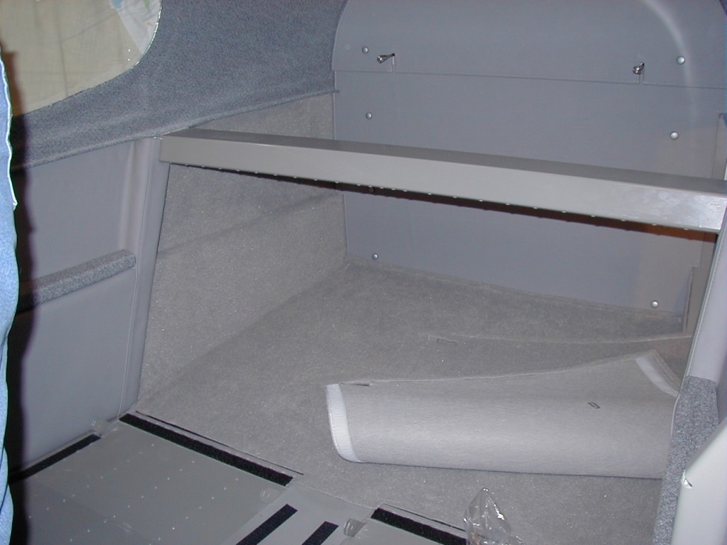

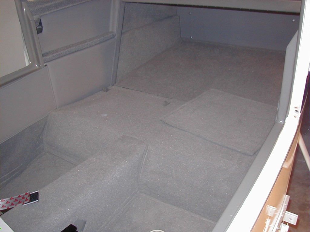

I am used to the configuration of my Cherokee with the seats out. With them out, I have room to slide an ice chest, guns and bags almost up against the front seats. How does it work in the -10? Is there a ledge or hump between the baggage area and where the rear seats were?
Pictures would be great if anyone has some.
Here
is a link to Tim Oslon's build log that shows a lot of the interior. Its flat aside from the seat belt mounting points.
Here's a couple of pics with the seat's out from Tim Olson's site of Tim's interior. Note that the seat back brace in the first pic is riveted in-place and is not removeable.
