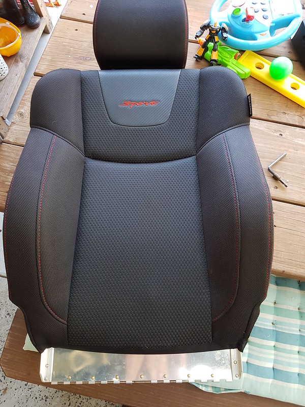

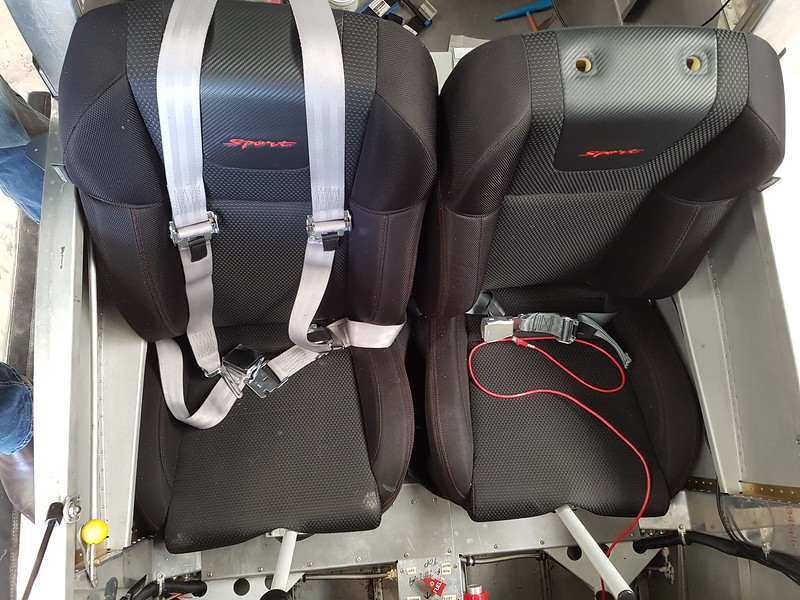

Another option may be to use automotive seats.
I found Suzuki Swift seats fit almost perfectly in the RV-9, when you remove the steel frame you can slide the aluminium seat back in its' place and voila!
And testing them out for space available before I had an upholstery shop cut out space for the stick movement.
