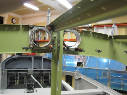

overhead installation
For those who have overhead console, is the scat tobe connect at the back of the console and pressurize all the console or you have some tubing that go to each vent??
The one on my rv-10 have 2inch scat tube, that connect to 2 smaller tube before it go to the back of the console and after smaller tube to the vent.
I don'T know if it woulb be better if i just connect the back of the console and let the rest open ( the vent not connect, just getting the positive pressure)
If it don't work, i would probably go with a naca on one side ( i already have a small door on the left side for o2 refill)
for the factory vent. The builder had the inside finish that cover this area. If i don't have to go there, i will try to avoid but i agree, i try another rv-10 before as a pilot and passenger. They are simple and effective.

The overhead console is pressurized by the scat tubing connected to a flange mounted on the baggage bulkhead. This eliminates the need to run scat to each vent. Not to mention that there really isn't room for that. The downside is that you really need to ensure that everything in your overhead is sealed, otherwise it will get chilly in the winter.
If you got the Aerosport Products and look at the NACA Vent Valve photos, you'll get a better idea on how others are doing things.
Edit: There isn't a good photo on that link. I guess I'll need to speak to the web editor. There are some other photos in the Photo Gallery. http://aerosportproducts.com/photo_gallery.htm.
Here is how I did the transition in my RV-10
bob
