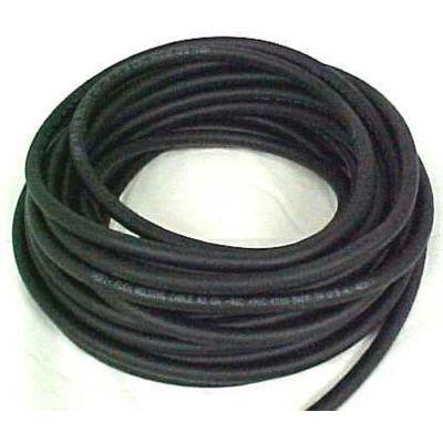

I have scoped out most of the other wires and ordered them this week, but I was wondering what gauge wire -10ers are using from the battery to solenoids to starter? Also, what routing does it take through the firewall?

I would suggest using 35mmSq SDI.
this is about AWG2 I think. SDI means Single Core Double Insulated.
The Flex you buy for say welding applications is fine but its only ever 1 layer of insulation. make sure it is a high strand flex at least.
We routed it down the RHS of the plane and through the firewall on the rhs.

#2 AWG cable. Many, myself included, use #2 welding wire. Home Depot sells a 50ft length for $68. You will only need about 20 ft but you can't beat this price. Make sure you use an anti oxidant paste on the connectors when you crimp the ends since it is not "tinned." It is pure copper.

For Bulkhead pass-thru, you can use a snap bushing or a Blue Sea terminal feed thru connector #2202.

I ran red #2 welding cable from Arizona Solar Supply
and came through the firewall with a 3/4" fireproof firewall penetration from Plane Innovations (an advertiser on this site). Seems to work good. I'll have two 1" fireproof penetrations to handle the rest of the wiring going through the firewall.
