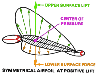

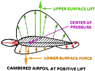

My curiosity was getting the best of me on this question and then I finally figured it out. Just like a wing, the HS is nothing more than an airfoil. The front spar gets more load because of the distribution of the lift across the profile of the airfoil. Here's a picture that represents the pressure along the length of the airfoil:
The majority of the lift is closer to the front of the airfoil, therefore the load at the front spar is higher than at the aft spar. This explains why there's the added spar caps at the front HS spar.
This is also, in part, why the forward wing spar is a very beefy structural element and the trailing edge is much smaller.

You are Right
This may not be a RV 10 ?
I added it to show angle of attack
From www.dynamicflight.com/aerodynamics/pres_patterns/
Thans Mike
Note:RV 10 Wing Loading 18.6 lb/sq ft
Wing Area 148 sq ft
The center of lift
now look at my anawer
So much for a short answer
