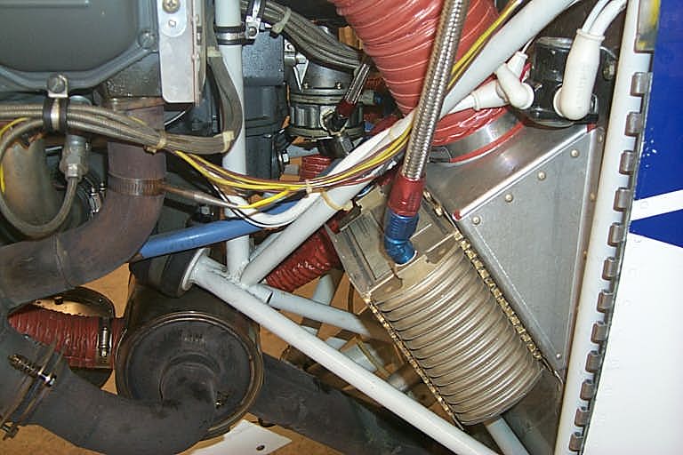

[5]This is the IO-540 oil cooler installation on N410RV.

[3] If your picture is the standard or stock Van's RV-10 cooler
installation, great. I can see some problems and can say the SW is a more
efficient cooler than the Aero-classic, Niagara or Positec.
[4] Nope, just talking, actually to Jeff who is having a problem.
Rational? Trying to help. :rolleyes: However if you think the N410RV oil
cooler installation picture you attached is ideal or ever good, I would
disagree. It violates a hand full of basic aerodynamic principals. With that
said Bees fly and they are not suppose to. So if you like it, that is cool with
me, I don't care.
[5] N410RV, the factory RV-10? Is Jeff's identical to that? Is that a
standard supplied part or recommended installation in the kit? Now that you
mention it, yes I do see a problem.
N410RV's cooler box has the duct entering at right angle to the cooler face,
into a wedge volumn, than back out almost in the direct opposite direction of
the air flow out the cowl.
:eek:
I don't mean to insult you but I got to be honest with you, looking at
N410RV's cooler installation with a critical eye, it's not that great. Part of the
cooler is choked from air (the narrow wedge area).
Even you can see what I mean after I point it out, it's convoluted at best.
The air flow is not even across the cooler core or optimal. If you think it
works great, that is all that matters, but we are talking about Jeff, who does
have a problem. I am trying to help him. Do what ever you want.
I'd don't know how Jeff's RV-10 oil cooler is installed or what type. No one
does based on the post. If RV-10's are like all the other RV's, the oil cooler
installation is left up to the builder and not supplied in the kit. It's possible I
am wrong. :eek: If Van supplies the oil cooler installation standard in the
RV-10 kit and it looks like the one in your picture, YES I think you can do
better.
If you don't like my comments please ignore. You make a suggestion, I make
a suggestion, Jeff the poster provides more info and we all work together to
solve his problem. I was not addressing you or N410RV. Just trying to help
Jeff. You obviously got it covered. All the best with your project.

The picture provided is the standard oil cooler design provided with the RV-10 FWF kit. It is designed for a 4" SCAT.

As I pointed out Van's Mounting Kit Part Number = EA 3" OIL COOLER DUCT, which I did mention before is especially terrible, especially for larger engines. The square shallow box top on the cooler is awful. It may work for a O320 but not a 540.
This kit is NOT used on the RV-10!

Thanks I did not know that, and no doubt its the standard installation. I agree that would be the last thing to look at and there is no need to point to the stock design as the problem, even if its not perfect. I am glad to hear Van went to 4" and is providing it stock to the kit. That is good. I think it will work fine. Regarding brand of cooler, I can say from experience that SW is better; however if you can get by with a Niagara or other brand at much less cost and it works for you, great. I find demanding engine installations like the IO360 angle valve or 540 take a good installation and cooler. With a "Standard" RV-10 cooler that will be good for most builders. No doubt some will have hot rod engines and other changes which may tax the stock set up. I know the small clone coolers have much lower efficency than the SW. The larger clones may be better. With the SW costing so much more I can understand wanting to go with the cheaper clone coolers.
