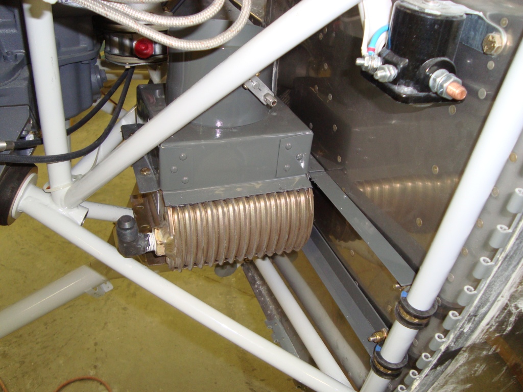

I did not use the Van's oil cooler mount. Looking at how the airflow changed direction by bouncing off the firewall, then changed direction after the cooler to conform to the exit airflow it looked like a horizontal mount would be better (photo attached). Note - the photo was taken during fit up. Final install has an adel clamp on the engine mount to the forward lip of the cooler.

Wish I had done this with my cooler as well. Unfortunately, kind of late now. I opted for a larger cooler on the stock mount...
I used the AirFlow systems 2006X cooler (same dimensions as the one Van?s sells for the IO-540). Never had a high oil temp - and I did a hard test lifting off near Phoenix in the summer and climbing to 15K? on my way home.
Carl
Data point. I have the stock cooler in the stock location and my oil temps are just fine year around flying between Northern Va, Florida, and Louisiana.

Alternative oil cooler
Any reason not to get this from Chief?
http://www.chiefaircraft.com/aec-8000215.html
Looks to be same size as stock, claimed 2 oz lighter and leaves wallet $70 heavier than the Van's part.
Just researching options. I know many went with oversize coolers but others didn't and have no issues...
Appreciate feedback.

None I could find. I planned to purchase this cooler before finding one used for 5 hours. I spoke to pacific coolers, who make that unit, and they claim it is compatible and better, in their opinion, than the niagra.
I am rolling the dice on the 13 row being adequate. I fabricated a turning vane (copied from a production add on) to help turn the air into the upper portion of the cooler. The cooler mount is a poor design that will leave a good portion of the air in turbulence at the bottom choke point and starve the upper half of the cooler. It is my speculation this is the reason that many suffer from high oil temps with the 13 row.
Larry
I put the upsized 07 cooler on a slightly modified stock mount and have never had high oil temp issues in Arizona. In fact, after a couple of winters I had to install a butterfly baffle just to be able to keep the oil temp in the green in cruise.
Myron,
Can you point me to where I can investigate an upsized cooler. Model numbers, etc. would help, as would some more description of your mods to the stock mount. Thanks in advance.
Sure. I got the plus sized oil cooler here. Specifically the 2007x
https://www.airflow-systems.com/category/aircraft-oil-coolers/
The upsized one is slightly taller than the standard. The bracket is easily modified by removing some of the faceplate at the top where the regular size nut plates go to make the opening larger to take full advantage of the larger surface area of the cooler itself, and then affixing a piece of angle stock on top to position the new nut plates.
Hard to explain but it should become immediately evident to you when you mate the two together.
I can send pix in a couple of days if needed.

Hi Mike,
The oil cooler Myron is referring to is from Air Flow Systems,the same people who make the Air-Con for the RV-10 etc.
The 2007X fits with only minor mods to the stock oil cooler mount.The instructions that come with it explain all.
I?ll post some photos when I get home .
