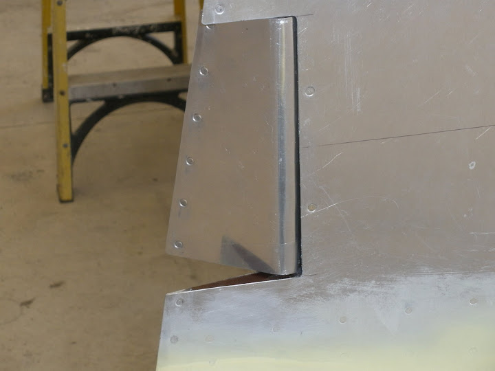

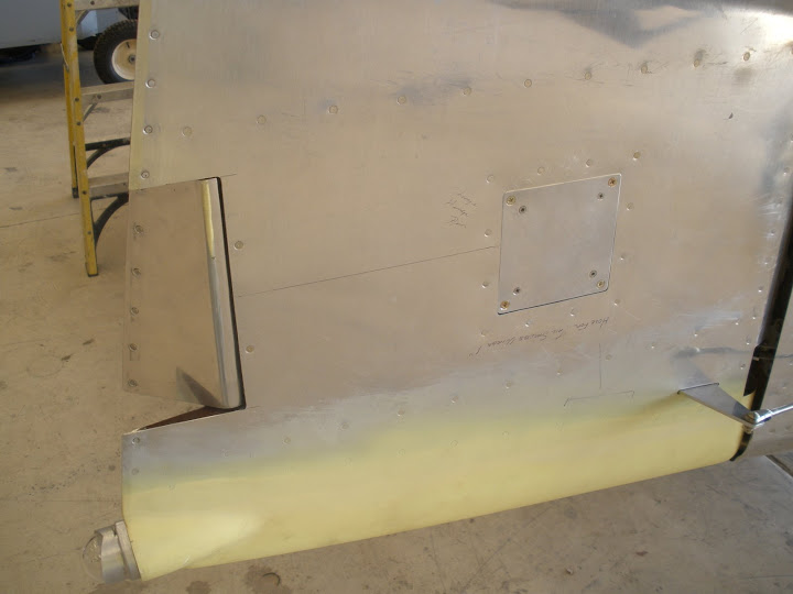

I noticed that Geoff Combs has photos of him installing a rudder trim servo and tab on his aircraft. Has anyone else done this, or does anyone know of the manufacturer of a such a system?
Bill
Do a search on Vic Syracuse's rudder trim. Then roll it out yourself. It would be easier to do while building but we added it afterwards OK.

This is what I am trying to duplicate.
http://combsfamily.phanfare.com/3161550_3455958

Building a trim tab for the rudder is a major PITA and a good way to waste at least a month (probably more) for the inexperienced builder. It's usually the first spot the rookie builder gets off Vans plans and also their first experience with how much time can be wasted when you're working off the map.
The spring system is much easier, but I don't like the knob at my knees and prefer the weight and cleanness of the servo.
All that being said, I'm planning on flying with my current rudder. However I plan on starting a second one as a rainy day project when I can't fly. That's when I'm going to take my time again and tackle the in-line tab and get it absolutely perfect.
A trim tab sounds so simple on the surface, but there is a lot of time to be wasted there.
If I had it to do again (and I'm not flying), I would build Vans standard rudder to get the project moving. Then I'd build a second with the perfect tab. A second rudder can be built pretty cheap; something like $150ish IIRC.

About the only thing I kept a time record for in the hole build was the rudder trim (integral) as shown on Mike's post. It took me about 80 hrs in a two week period. It looks good and with just over 45 hrs on the hobbs works as designed. We have never run out of trim but are very close to the limit in travel. Mike's photos don't show the side opposite the hinge. On mine I rolled the trim skin so the gap (opposite the hinge) stays the same as the trim is actuated. Getting this gap correct took most of my time, (trial and error).

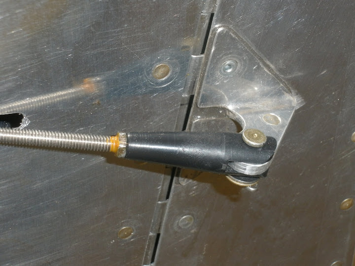

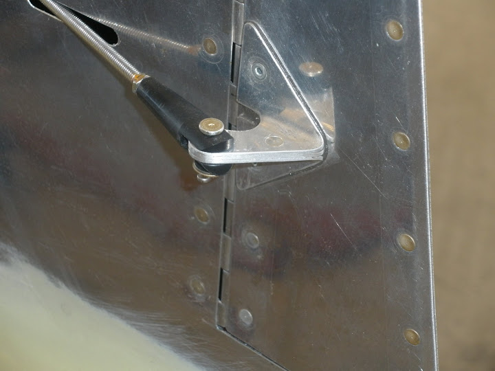

More photos
Here are some more photos of the rudder trim on my plane.
Will have a report on the effect on flying soon :D

How's the rudder trim working out Mike? I see you up and flying now.
Works well, half ball takes a 3 or 4 second activation of the trim-------probably less than half travel?
You can definitely feel the tail wag with the trim.
Glad I made the mod.

I have an electric rudder trim cut into my rudder as Bill was asking about. It works great. I would do it again. I have my trim switch next to my
china hat trim on my infinity grips. As for which one works better they do the same thing so one is no better than the other. I would say the piano hinge
looks like more of a add on but is also easier to install. As for only using your rudder trim very little I disagree. If you have it you will use it a lot more. There are days that I might use it more than others but I do use it and fine
tune the ball always when in cruise.
