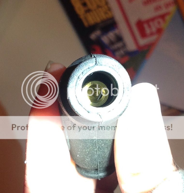

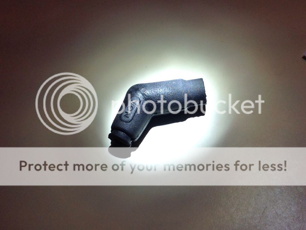

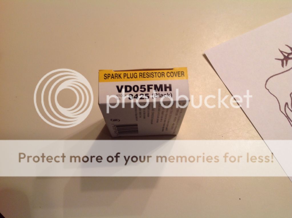

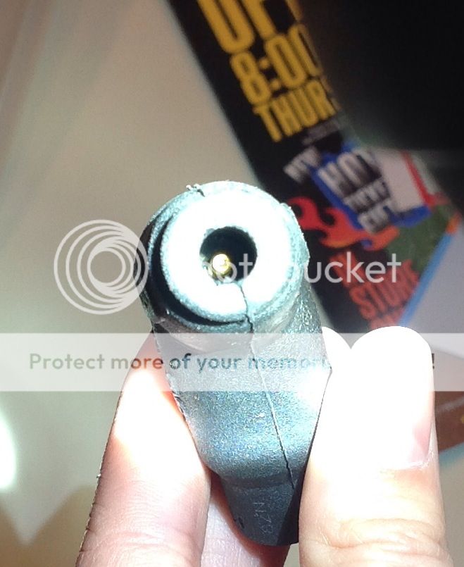

Article follow up pics!
I thought I would do a follow up to the Cactuspilot article. I google then bought a couple of the rubber NGK spark plug caps using the part number in the article. They cost $6.30 each at this web site:
http://www.ngk.com/product.aspx?zpid=20087
The cheapest I could find these from one of the three Rotax dealers was $26.00 from Lockwood so this is some good info if somebody needs one. You can save $20 bucks each. Here are a few pictures to go with the article.
The rubber cap.
Where the spark plug goes in.
Threaded end where ignition cable goes in.
Box with the Part number on it.
I had one rubber spark plug cap lose its suction and come off showing the Symptoms talked about in this thread. Now with the above article and these pics you can see how these go on. :D
