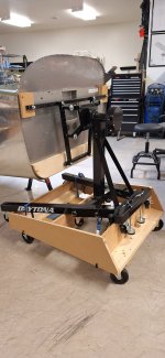

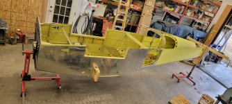

QB or slow build, makes a differenceHas anyone ever used a rotisserie for building a RV10? I haven't been able to find any info for the 10 but found lots of 14's
QBQB or slow build, makes a difference

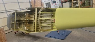

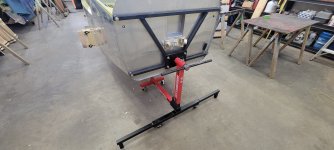

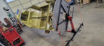

Do you have any pictures that you would be willing to share ?Definitely!!! Super useful. We used one on our 14 and loved it so we modified it for the 10.
Okay...I've gotta ask...Why does QB make a difference?QB or slow build, makes a difference

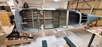

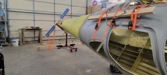

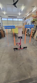

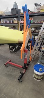

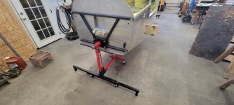

Yes. I am using one. I bought it from a friend that previously used it on a 14.Has anyone ever used a rotisserie for building a RV10? I haven't been able to find any info for the 10 but found lots of 14's
Thanks Chris, for the response and picture.Yes. I am using one. I bought it from a friend that previously used it on a 14.

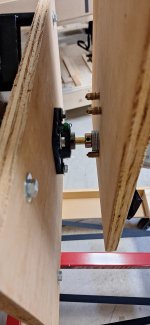

I made a few mods, and added a structural connection between the two engine stands. It is really nice to work with.
One tip - don't bother installing your steps until after you are done with the rotisserie.
