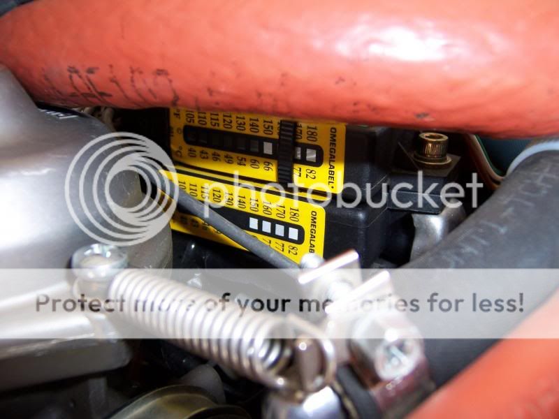

It would be a very sound practice to buy some heat sensitive tape strips. The target heat to stay away from is anything over 175F. So a strip that reads anywhere from 150F-220F may be a good place to be. Place this heat strip on the ignition module. If the heat strip keeps popping above 175F you might think of a way to get rid of some of the heat after your done flying. If you need to replace your modules the newer soft start modules are going for around $750 for the pair, but may not be this way forever..

Both of mine failed between 400 - 500 hours. I installed heat strips, and they have stayed at 150 degrees, so not sure what to expect.

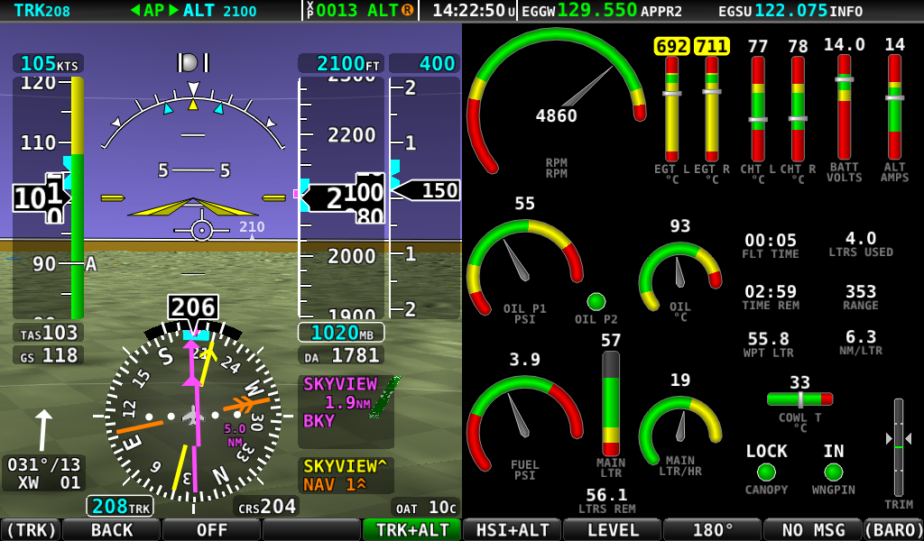

We ended up with a spare OAT probe (one with the airframe kit, one with our UK-sourced SkyView system, bought pre-Van's SV option).
I fitted this under the GPS aerial bracket as a poor-man's fire warning system and generated a widget to display it on the SV.
I think the max temp indicated on the OAT is 56 degC (132 degF) and if the ambient temp on the ground is up towards 30 degC (mid 80s F) then the cowl temp will reach this upper limit during the pre-flight power checks.
Once on the move though, the cowl temp seems to sit around mid to high 30s degC (90s F) - obviously depending a bit on the ambient temp.
I think that the excellent Van's cylinder cooling shroud will keep the heat away from the ignition modules. Many other 912 installations don't have any shroud over the cylinders (Tecnams for instance).

I reported incorrectly about the temps. They are at 140 degrees. I put them on the sides so I could see them without removing anything. I made mention of it back when it happened.
The first, I was flying and the engine reduced RPM, then picked back up in cycles. I'd say maybe 100 - 200 RPM. The second failed on the ground. Checking mags, and it was ready to die.
I notice the CHT's increase after shutdown - I only have the data for the few minutes after engine shutdown until I download my Flight Data onto the thumbdrive. So, maybe they continue to increase substantially more after I power down the electrics.
On a hot day (for these parts) of around 90 deg F, the CHTs sit around 90 deg C in flight, but increase to around 100 deg C after shutdown, as shown on my data dumps. The EGTs drop rapidly after shutdown, while the oil temp remains constant.
