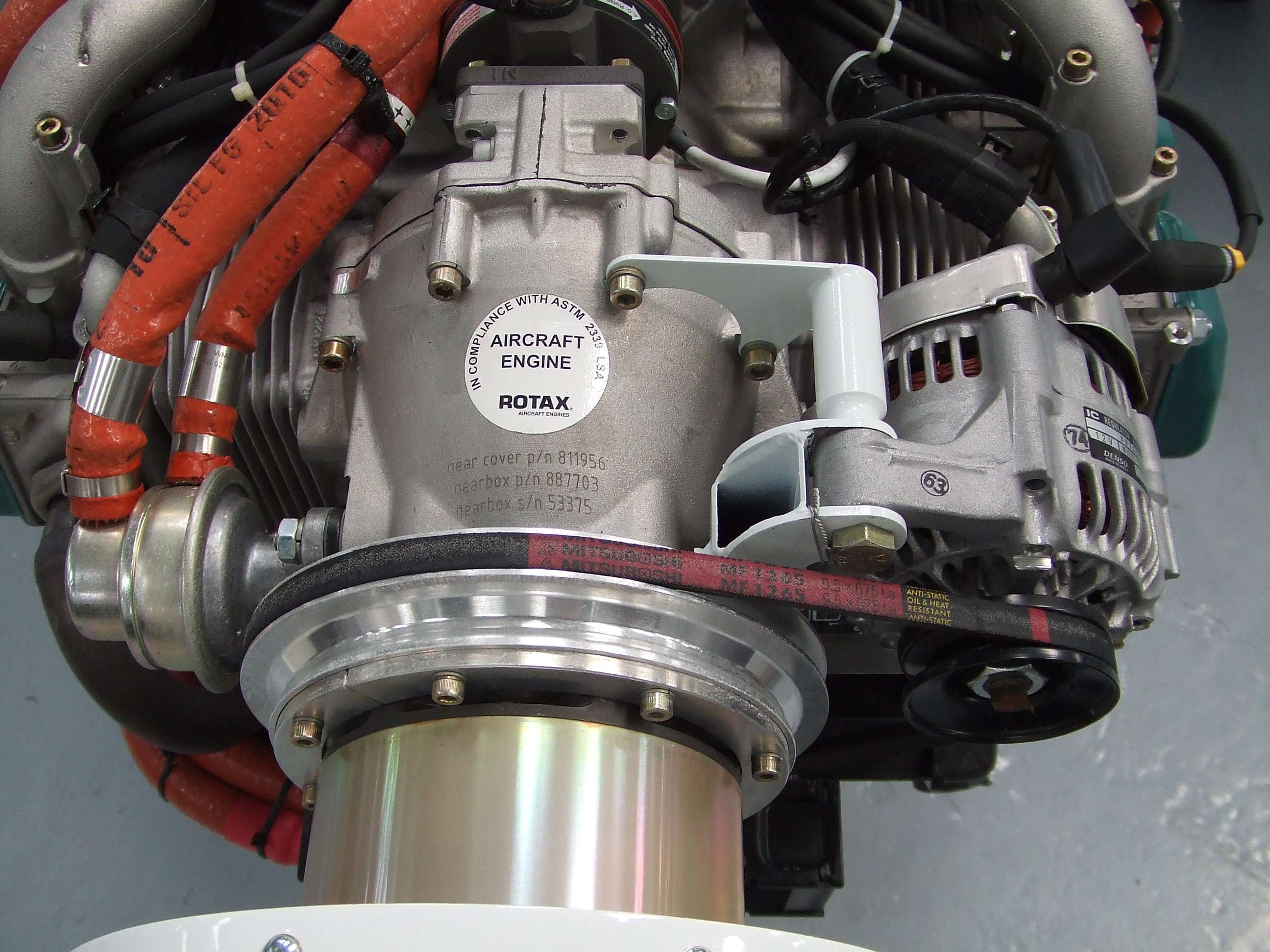

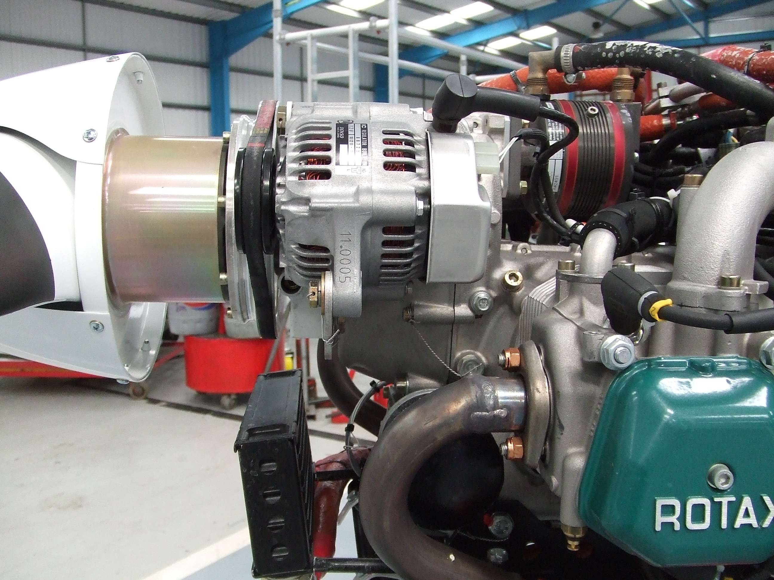

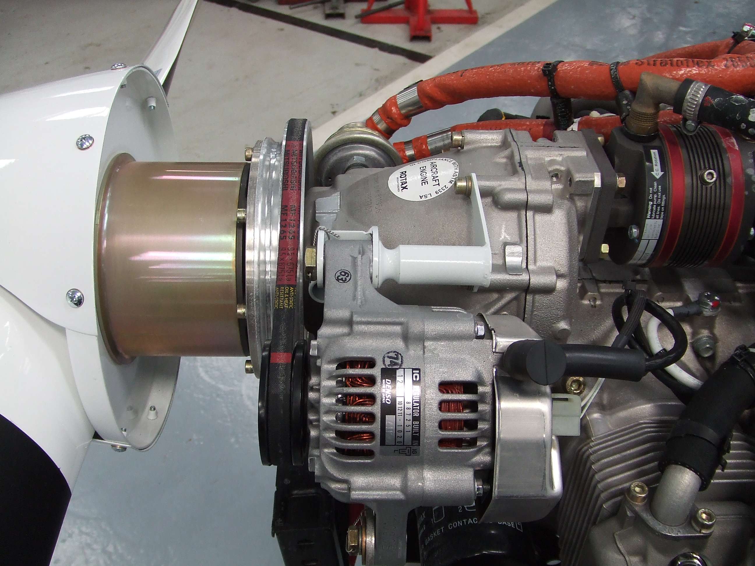

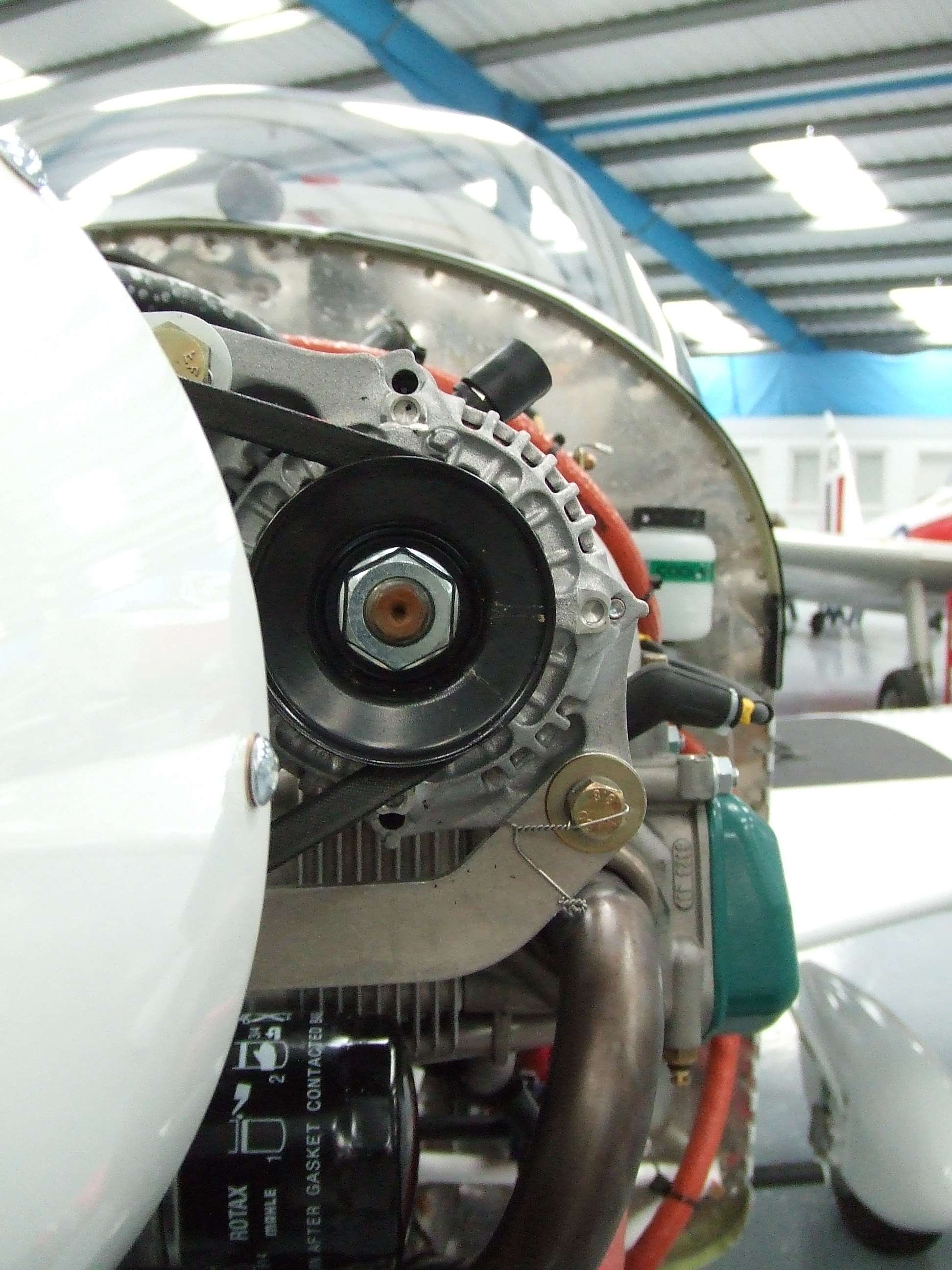

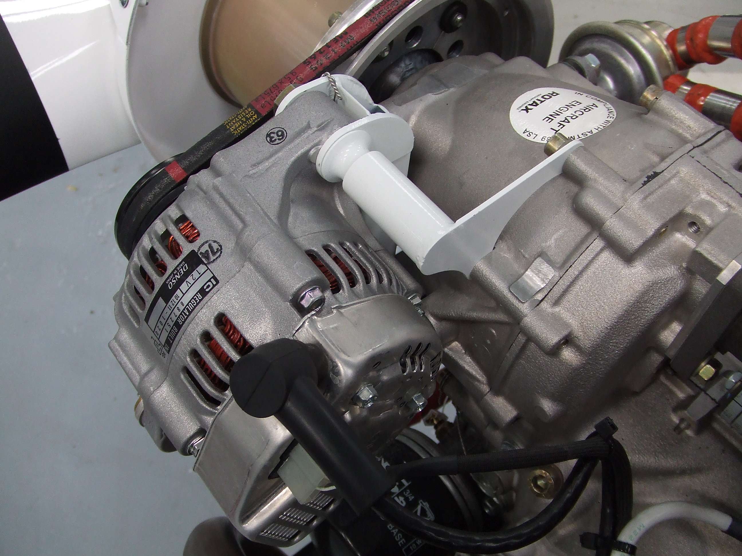

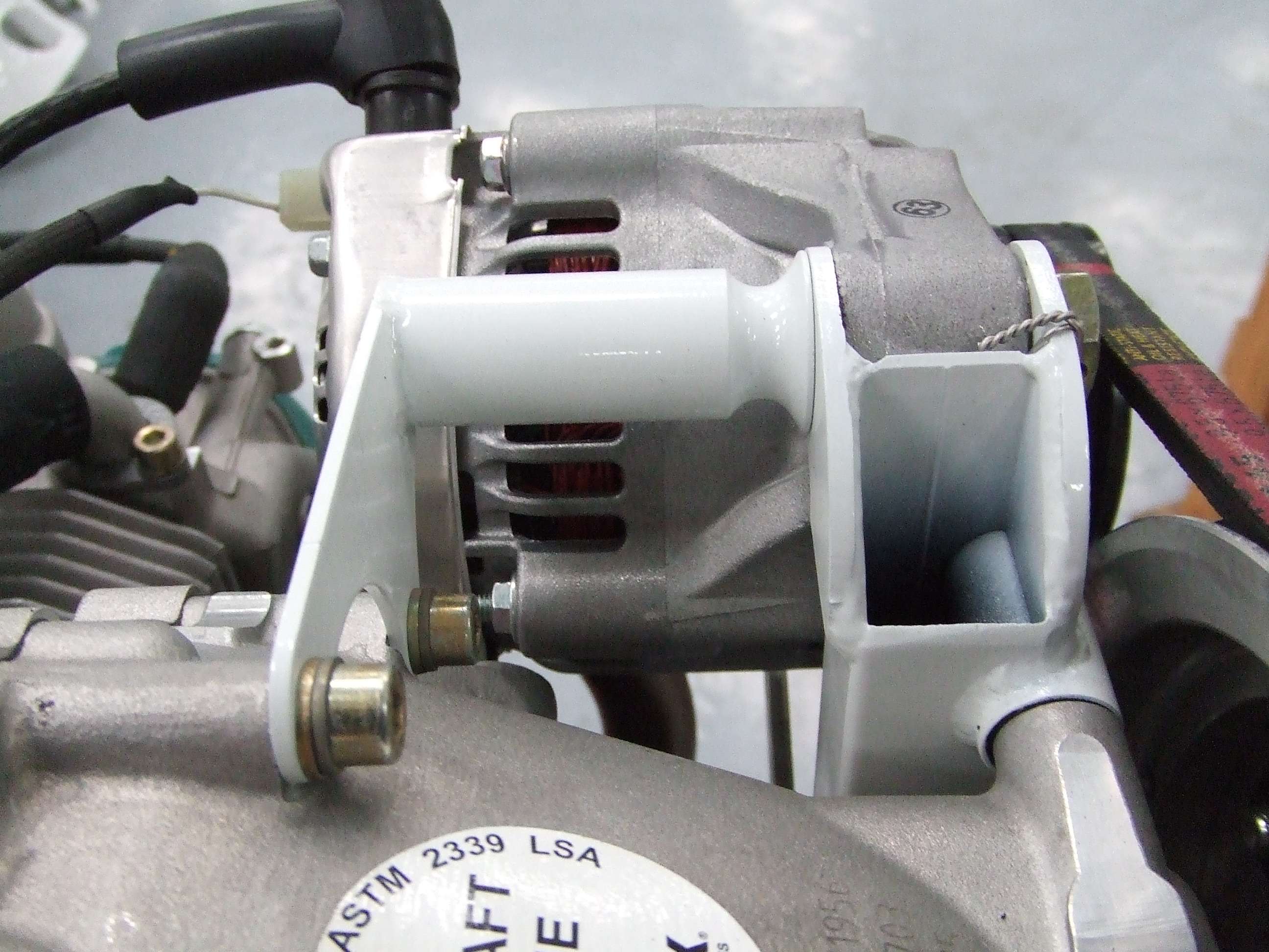

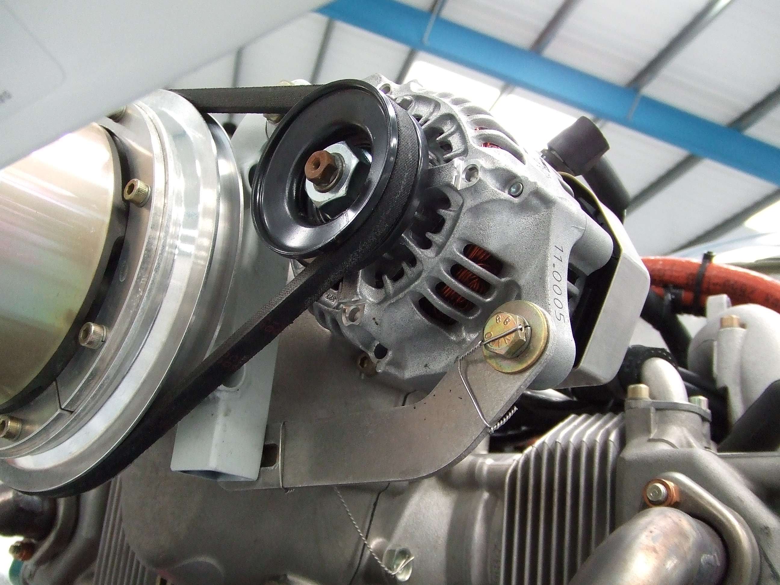

Some time back I promised some pictures of the external belt driven 40A alternator that is a Rotax option.
These pictures are of the alternator installed on a Tecnam P2002-JF and should give an idea as to how much space is needed.
Without having the engine sub-kit as yet I ask in ignorance. My two questions, based on this photo:
1) Is that some type of prop extension on the front end of the tecnam--can't recall seeing that type of structure in the RV-12 photos.
2) Would this alternator add a wart on the RV-12 cowling?--looks like the hoses on the side opposite the alternator are just about as pokey-outty as the alternator.
It looks like it would interfere with the cooling shroud air impute and that the front of the cowl would need some rework, seems like it would be a very involved project to sort out.

Next time I have the cowlings on the 12 I'll take some shots from similar angles for comparison.
Jerry,is there any chance you may look at adding the alternator at a latter stage? It looks like a lot of extra work.

What is the red and black thing bolted to the gear reducer on the aft side - that has one hose coming out of the top?
Never mind - it's a vacuum pump. We don't have one one the RV-12. Wouldn't it be nice if there was a small alternator that would be driven from that attachment?

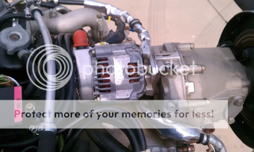

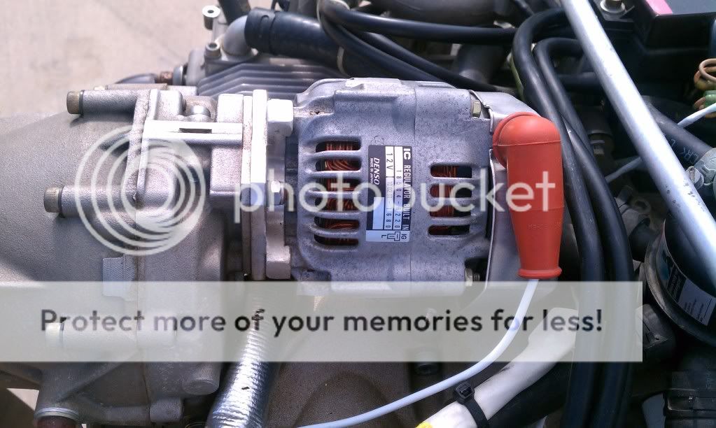

If you have to change it then this is the way to go. :pIt will fit under the cowl, all you have to do is modify the cylinder cooling cowl.
This is not on my plane. It was on another rotax I saw while walking through another local maintenance facility
Numbers on it a 18504-6220 & 10 02 11-1680 DENSO for you google guys.
Heat is the enemy
The limiting factor of the alternator is heat. If the alternator can be kept cool, it can continuously operate at its rated capacity or perhaps even a little more. Getting the most out of the existing alternator will be easier and will weigh less than installing another alternator. The challenge is determining the maximum operating temperature and installing a temperature probe to make sure that limits are not exceeded. And of course the regulator needs to be kept cool too.
