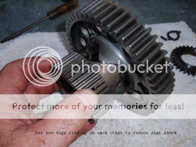

It seems that everyone agrees that there is less wear on the gearbox if the engine is operated at 1800 RPM or above. The disagreement is over what RPM the idle stops should be set at. Roger is the engine expert and prefers 1800 to prevent gearbox wear. Scott is the airplane expert and prefers 1400 for shorter landings, but keeps the RPM above 1800 with the throttle. Roger is concerned that some pilots might not pay attention and let the RPM get too low. I am one of those pilots who does not always pay attention to the RPM and my engine idle is set somewhere around 1400. I always look at the tach after engine startup and keep it in the green; but I never watch the RPM during the flare and landing. And so I analyzed my Dynon data from a recent Young Eagle's event where I made 10 or so full stop landings. On final approach with the throttle closed, the RPM is somewhere between 1800 to 2000. As the wings stall, the RPM is about 1700 and drops to 1500 as the plane slows down. The RPM did drop to almost 1400 on a couple of landings when I was slow to add power after landing. The time during which the engine RPM was between 1400 and 1500 varied between 0 - 8 seconds per landing. I am concerned? No. I routinely operate from a short grass strip. It will cost a lot less money to repair worn gears than to repair a damaged plane if it runs off the end of the runway. The RV-12 will float if RPM and airspeed are not controlled.

I usually set rpms at 1700 and make sure the owner understands not to just sit there or warm up there. I does happen and it happens a lot. By not setting it artificially low for most users you help keep them out of the gray area.
I have no issue with lower rpm settings for the engine IF the user understands the issues involved with sitting at low rpm on the ground. It will never get that low in the air.
The other issue for me is that thinking a lower set rpm controls the speed of the plane and its touch down point. Once down at those rpms (i.e. 1600-1800) the speed at which you approach or actually touch should be the same. The only thing that should change is how far the stick is back to maintain that preferred speed. 1400 up to 1600 is just not needed. Pull the stick back at 1500 or 2700 and the speed will drop and you will stall at the same speed. The only difference landing at an idle of 1500 (which won't be that anyway as air passes through the prop) and 2700 rpm is you'll just have the stick back farther to keep the exact same speed at both throttle settings. I demonstrate this to all the high time pilots transitioning from a heavier aircraft to LSA. The higher the rpm usually the higher the nose just before touch which helps keep the nose off and touch mains first and allowing the nose to settle, but even more importantly for me and especially in bad cross winds it allows better control and air flow over the tail and elevator. When you get too slow and loose that air flow then these inputs are sluggish and sometimes needs big inputs. With a tad rpm on landing you have great rudder and elevator control which comes at the same speed as the guy with the low rpm landing.
I would guess about 70% of the people I work with keep this technique. They not only more smooth and consistent landings, but all of them can land in pretty severe cross winds because you maintain better directional control and not soft inputs.
There are many ways to land and I think everyone should learn them all as they all have a time and place for use. Learning them all keeps panic and stress out of the cockpit during more complicated landings and maneuvers and gives the pilot a much larger mental toolbox to draw from.
Several of these things like idle landings verses some throttle at landing and less rpm settings verses lower are all Personal preference items and there isn't any issues unless the end user fails to understand that there may be consequence for things theyy don't fully understand at this particular point in time.
This is exactly why we talk about these and we all learn from each others class teachings and actual experience with our individual aircraft and engines.
As my professor used to say: The mind's a terrible thing to waste and when you think you know all of it then just open the next door and there will always be more.
The Rotax instructors that teach the instructors still keep learning according to them.

His own words below 1800.
"If you go below that it introduces more wear and tear on the gearbox."
So, I know this is likely to be impossible to quantify, but in general, how much more wear and tear? It's like I tell my doctor when he goes on about my triglyceride levels: "Doc, if not eating bacon means the difference between only reaching age 83 instead of 85, that's a trade I'm willing to make on quality of life grounds, although I reserve the right to change my mind when I'm 82."
In your experience, how damaging is it to use a non-optimal idle speed? I'm running 100LL exclusively (with Decalin), so I'm already looking at some earlier-than-nominal gearbox issues, but for various reasons that is a trade I willingly make. Is this idle thing in the same neighborhood of increased wear and tear, or is it horrendously bad?
Hi Dave,
It isn't horrendously bad at all. Admittedly from all instructors it just cause wear and possible extra maint. to a gearbox during its life. It may cause some extra cost during a gearbox inspection.
All this is predicated on how long and often the engine is allowed to run at those rpms. Every single individual is different and there is now way to accurately predict an outcome.

Does it sound more like rpm and harmonics or a definite metallic rattle?
If the rpm is too low the 30 degree play in the dog gear can move back and forth slightly and may not be fully engaged leading to this sound. This comes from the exhaust pulses due to the higher compression. If this is low rpm caused increasing the rpm should make it go away.
Wind hitting the prop from the side or back can give it an odd harmonics and rpm change that the human ear can pick up. This is usually more rpm and harmonic and usually isn't a metallic rattle. When I carb sync I always turn into the wind. That 30 degree play (which is only 15 degrees in older engines) is the one you feel when you put the crankcase locking pin in place and move the prop the 30 degrees through its arc doing the gearbox friction torque check during an inspection. As you can see this junction is not a solid hook up and can have movement back and forth.
Here is a picture:
https://plus.google.com/photos/115442716220402518613/albums?banner=pwa
I hope this link works.
