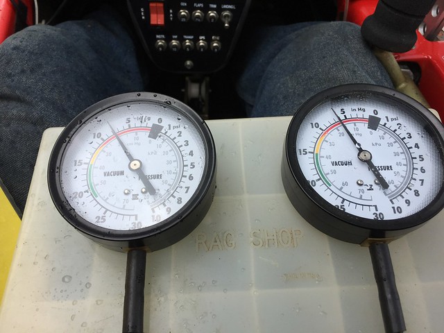

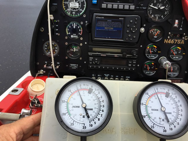

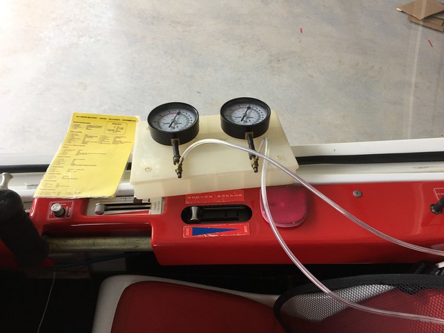

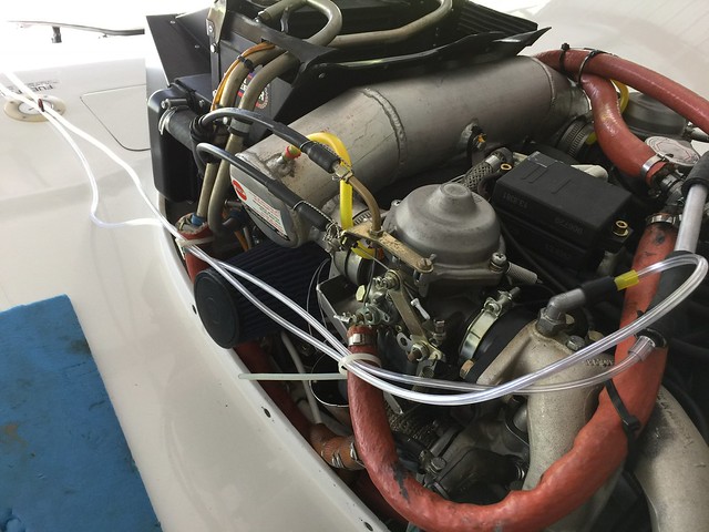

Installed new Throttle Cable and worked through the mechanical sync procedures.
Attempting Carb Sync with Carbtune (2-column) vacuum gauge marked in centimeters of mercury (cm-Hg). Have also double-checked for leakage opportunities in the hose connections.
This is what I’m seeing in the engine runs:
Left carb shows 2 cm higher vacuum at 2000 rpm idle (Left side – 24cm, Right side – 22cm)
Both sides show equal vacuum at 3500 rpm.
As throttle advances above 3500 the Left side vacuum decreases more rapidly until it’s about 1.5 cm less than the Right side at which point that the bars disappear off the lower end of the scale around 4800 rpm.
It's puzzling to see the Left Side vacuum Higher at idle and "cross over" to read lower at high power. Anyone else seen this? Nevertheless...
Question: How close is “close enough” i.e. how much differential will the Compensator Tube between the carburetors “compensate” for? According to my calculations a 2cm differential is about 2.5% of one standard atmosphere which doesn’t sound like much. However, if the gauge is accurate that 2 cm is around 9% of the lower of the 2 vacuum readings at idle. The 1.5cm differential would be about 20% of the 8cm indicated vacuum at high power.
Will appreciate any comforting words, advice, or recommendations to address the differences.
Sincere thanks as always.
This was always confusing to me...so I went to the Rotax training class in Tucson. Whn syncing your carbs, you first sync the "idial" circuit/jet around 1650rpm (Adjustments are made with idial adjust screws).. Then run engine up to 3500 rpm and sync "main" jets (this is done by lengthening or shorting the throttle cable adjust bolts)...it is really that simple. The low and high sync points are totally different.
Check your gauges that they read equal (the same vacuum source); then you are merely balancing carbs to read equal vacuum at those two points.
Edit: I mis-spoke regarding syncing "main" jet...@ 3500 rpm, what you are syncing is the needle jet (intermediate rpm range); the fixed main jet (upper rpm range) doesn't require syncing.

Thanks Ric, that's what I thought too. But it isn't working out that way for me. Like "squeezing a balloon". I'm starting over again and will (again) follow the procedure exactly. Must have screwed up something in the process of "overthinking it" as I sometimes do.

Dave...it doesn't normally take much turn of the idle screw or throttle cable nuts to effect change; also much easier to do while engine is running...just have someone you trust in the cockpit😳

I've done BING carb synch dozens of times, albeit mostly on BMW airhead motorcycles.
Two different adjustments are in play:
1) At idle, the throttle cables should have enough "play" that the idle is determined solely by the position of the idle screws. Get that right first. Make absolutely sure the throttle arms are firmly against the idle screws at idle. If not, adjust the barrel adjuster involved to make sure they both are.
2) At whatever midrange setting you choose -3,500 seems about right - it's the cables that determine the synch. Adjustment for that is with the barrel adjusters. As long as that adjustment does not eliminate the "play" in the cables at idle - it can - idle speed should not be affected by the midrange synch.
Finally, make sure your "chokes" are fully off. On my Sky Arrow the "choke" cables are really long and the return springs seem marginal at best to close them all the way against the stop. I think I'll look for slightly stronger return springs while I have everything apart for my annual.
As an aside, "choke" is put in quotes because the BINGS don't utilize a choke, per sé. Rather than "choke" the flow of air to the carb to enrichen the mixture, the BINGs use a separate starter circuit. I think most pilots/owners are aware of this, but some newbies might not be.

As a follow up, I just did my carb balance as part of my Sky Arrow's annual condition inspection. It's not on my checklist, and I did not get around to it last year and figured it was about time, though my engine did feel about as smooth as always.
Everything is a little tougher with a high-mounted engine and a pusher prop. This time, I hooked up long extension hoses using some oxygen hose I had and ran it up to the cockpit:
It appears I was overdue:
Anyway, the Law Of Primacy is still strong with this one - in spite of the previous discussion in this thread, needing more throttle on the left side led me to adjust the barrel adjuster to take slack out, which, of course, is backwards - you need to screw the adjuster in to allow the springs to pull the throttle lever towards a more open position. All opposite to my BING experiences on BMW's.
I was wondering why my adjustments - in both directions - seemed to be having little or no effect. I'd loosen the lock nut, screw the adjuster in or out and tighten the locknut again. I was missing the fact that the adjuster on these carbs are not threaded into the support arm - I thought they were. After that "Aha!" moment, it only took two tries, adjusting the nut on the barrel side, to arrive at this:
It appears about 1/2" off in the photo, but the two vacuums were tracking pretty perfectly throughout the rpm range. There may be some parallax error in the photo as well.
Thanks for the input and corrections - I think it finally got through to me!
