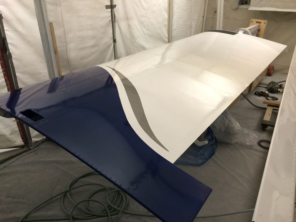

Do a search for "wingamajig"--my answer to rotating the wing in a rather cramped paint booth. Lots of pictures of the construction.
Here is a picture of it in use in my garage-based paint booth:
