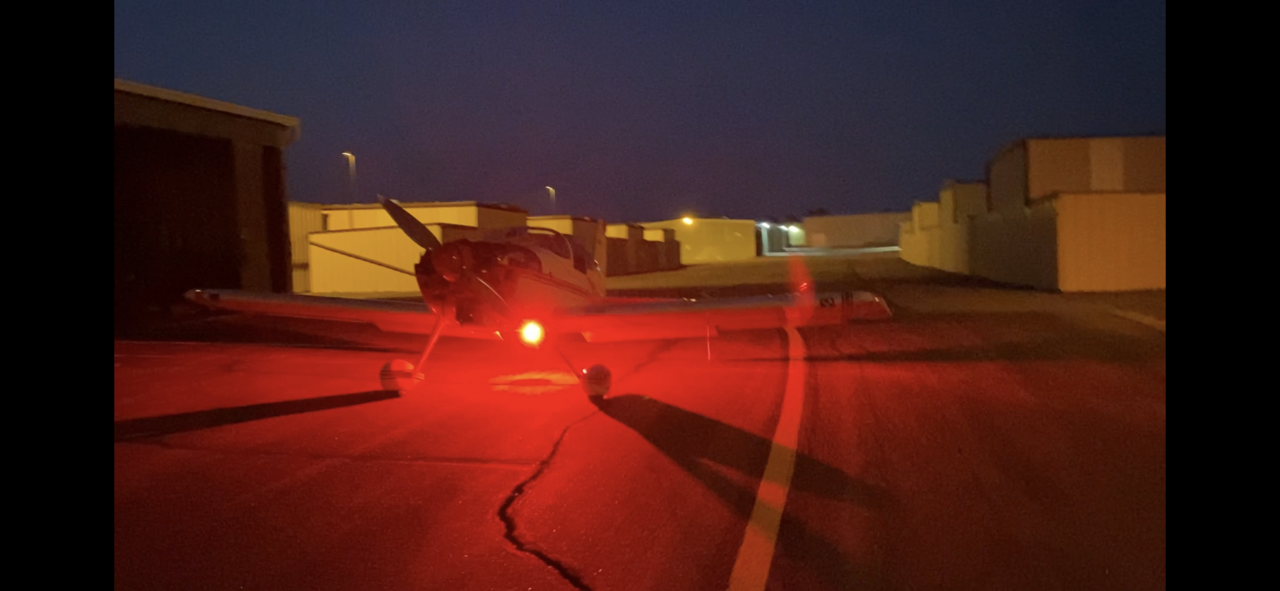

I have a new factory built Waco YMF with very small red very bright led flashing light which takes the of a red rotating beacon. It is located on the belly just aft of the engine in the landing gear area. It is hot wired to the master switch and is very effective day or night.

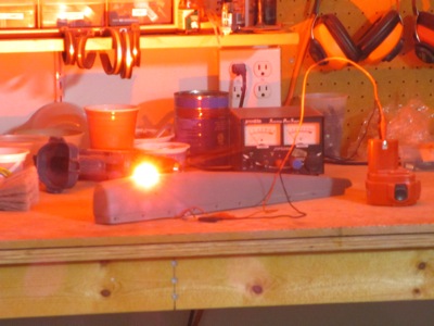

FWIW I use the Kuntzleman Red LED Beacon on my airplane and it is SUPER bright.

I’ve installed one of these on my last three airplanes, two on the top of the VS, and one on the belly, and very happy with them.
I recommend the belly under the baggage floor. It’s easily seen by others on the ground day or night, but unnoticeable from the cabin in the air.

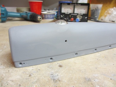

Beacon in top VS fairing.
VS fairing. Sanded grey gel coat off & mounted red LED strip inside. Coated in west systems tinted red & top coat of metallic silver.

Hi Clay
Sorry it's taken so long. I replied the other day but the post was lost in cyberspace.
My VS fairing went through a transformation. The beacon was the easy part.
1- Sanded off the grey gel coat. It's only a thin layer. I filled it back to normal thickness with a layer or 2 of epoxy & cloth. This turns out really transparent.
2- Made 2x brackets to mount across the inside of the fairing. I installed nutplates in the middle of the cross brackets so I could screw a light mounting plate to them from underneath. Brackets were installed using 3/32 size countersunk blind rivets through the fairing skin (Didn't know you could get these. They're great). I also used a small amount of flox to act as glue. I covered the rivets with a layer of cloth on the outside to hide them.
3- Made a light mounting plate from 16 thou Al. Attached 2x 6" strips of red LED to the plate. The strip has 2x red LED's per inch. This plate fits inside the fairing & screws to brackets squashing the LED strip between the bracket & plate. You can adjust the position of the LED strip so the bracket covers a control diode & misses an LED. The plate is easily removed to change the lights.
4- I wired the LED strips together & connected them to a strobe control box I had. Mounting this is a work in progress. Depends if it's able to stay in place after flight testing & weather it interferes with the HD camera mounted on the front of the fairing.
5- Finished off with a layer of clear epoxy tinted with transparent red from nordglass. Then a final coat of clear with Nordglass metallic silver.
6- It is hot wired to the master switch so no additional switch required. It will also act as a telltale for when I accidentally leave the Master on.
I'll try & get some pics next time I'm in the hangar.
Cheers
AB

EDIT. I found this idea. :D
I cannot in good faith recommend the above as you will be disappointed with the highly intermittent and unreliable operation, however, there is a similar alternative produced in southern Alberta that is much more reliable and better suited for aviation applications. 😁😉
Here is the YouTube video of the Aveo “beacon”. Bear in mind that this is a quick and dirty video with no production value. I was just trying to get a feel for the brightness. There aren’t even any airplane parts in the video but to keep it RV related, it was taken just outside my future RV factory, once my parts arrive.
https://youtu.be/-8sc34QnSPg
The only audio is my neighbor sanding something on his deck. You may as well hit the mute button.

I use this. Inexpensive, very bright, small and adjustable. The VTX609R only protrudes 1” round above the surface of the skin for 360° flash...
...I recommend the belly under the baggage floor. It’s easily seen by others on the ground day or night, but unnoticeable from the cabin in the air.
Do you have any pictures of the VTX609R installed on the belly of your RV-10?
I'd like to get an idea of how visible this placement is on the ground during the day.
