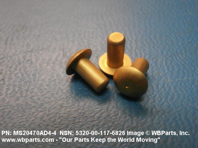

I'm a new builder with a stupid question... What size and type of rivet should I use for the vertical stabilizer upper and lower hinge assemblies?
More importantly, how do I figure this out from the plans?

All hardware is called out in the plans. Read section 5 of the plans to understand terminology. Rivets are called out in the plans by the rivet ID such as "LP-4-3 12 places" and usually has an arrow pointing to the area being referenced. Reading section 5 is very important along with the other book that came with the kit. I think it's called aircraft hardware and construction or something similar. It's a paperback book.

Page 06-02 figure 3 calls for AN470AD4-7 rivets

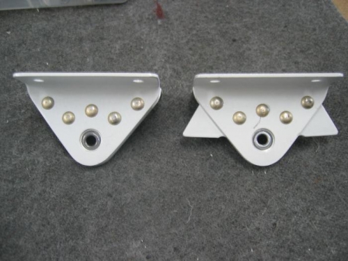

My thanks to everyone for their insights and info! I managed to finish the two hinge assemblies. First, I went to sec 5 and did the calculation for rivet size. Just as I finished, a builder happened by and showed me where the rivet size was in the schematic all along. Then I took about an hour to figure out how to put together and use the Avery rivet squeezer. And with that I finished!
