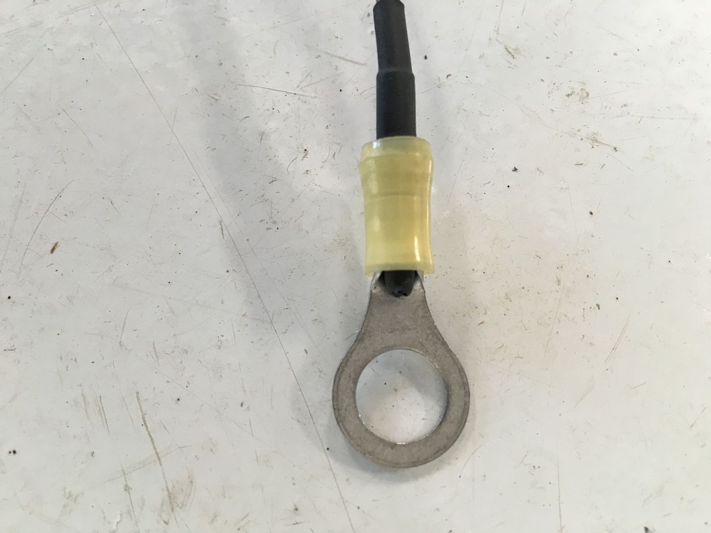

The next trick is to put your temperature sensor in close proximity to your cylinders. A 3/8 inch ring terminal will do the trick (Aircraft Spruce part # 35112). You just need to insulate the thermocouple wire junction (electrically) from the ring terminal. Let me say that again. The thermocouple wires must not ground out on the ring terminal or it will not work. Don't ask me how I know this. Heat yes, Electricity no.

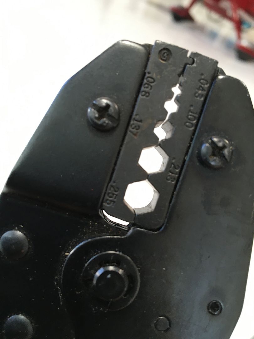

Don't use your normal ring terminal crimper here, instead use the Hex Crimper that you used for those BNC coaxial connections. The aim is to squeeze down the tube of the ring terminal enough to hold the wire in place without damaging the shrink tubing insulating the wire, because if the wire grounds out: It will not work.

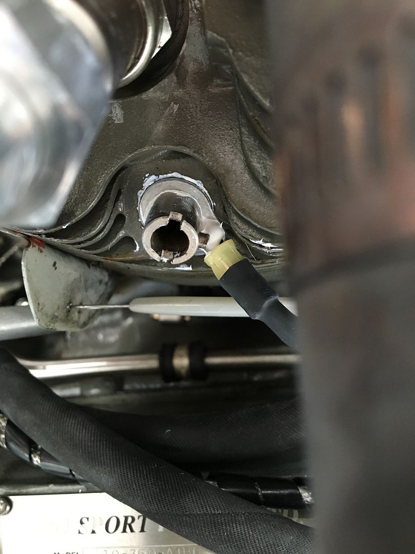

If you have some Silicone Heat Sink Compound laying around (Part # 09-37450), you can use a little to help get good heat transfer from the cylinder to the Thermocouple Wire Junction you have made. *Note, not shown, there is a washer under the ring terminal to bring it up flush with the surface of the cylinder for a better fit.

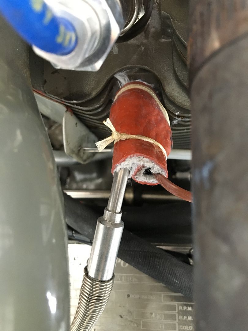

Now plug in your (Heater, CHT Sensor, etc) in the usual spot and use some Fire Sleve to insulate it.
