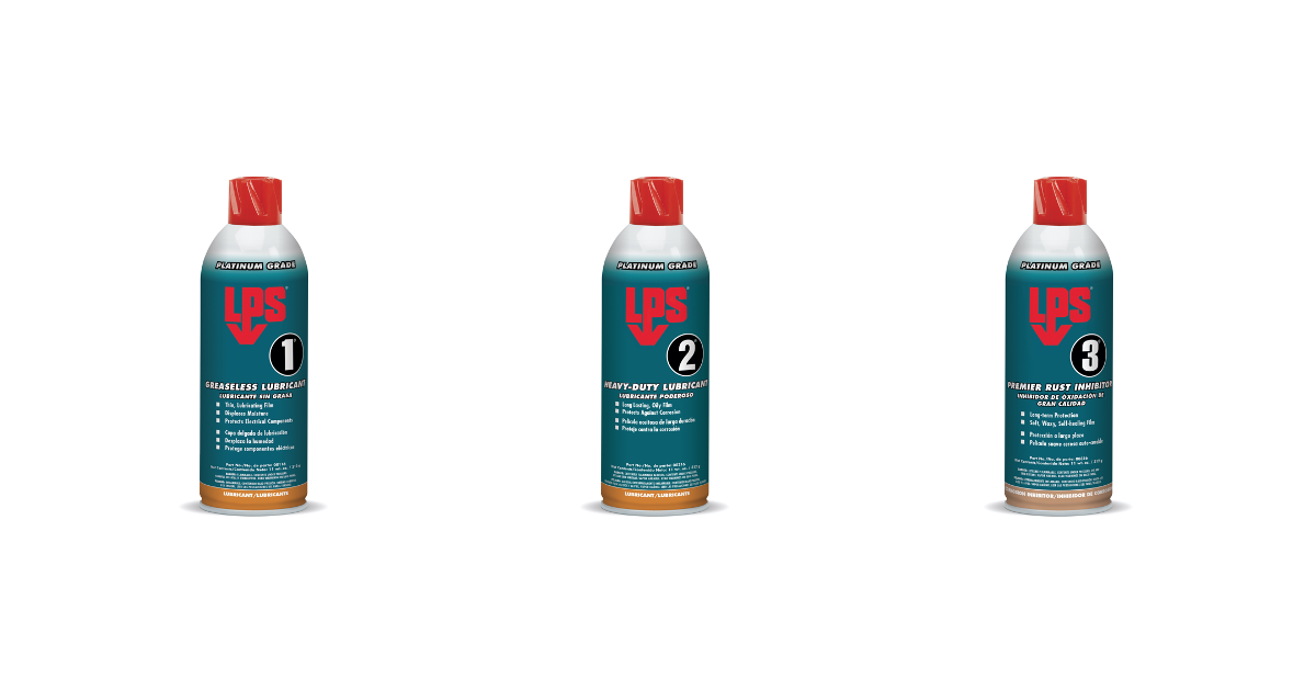

I use LPS2 on all rod ends and pivot points (like when drilled bolts or clevis bolts are used as pivot points such as on the ends of the rudder cables, etc.)
LPS2 is a wet film lubricant so is does a good job of lubricating and protecting from corrosion, but being a wet film lube, some people don't like it because of the possibility of it attracting dirt / grime. I have been using it for decades and haven't seen any negative impact using it on external components, but I lube external ones more than just once per year.
LPS1 is a dry lube lubricant, meaning the liquid portion of the spray evaporates after application. It works ok as a lube for light duty but does not provide as long of a lasting lubrication and it provides minimal corrosion protection, though it is probably a better choice for those worried about attracting dirt.
LPS3 is a corrosion inhibitor. it leaves a slightly waxy protective film. It should not be used as a lubricant.
Link to a quick rundown of the differences and suggested uses of the 3 products.
