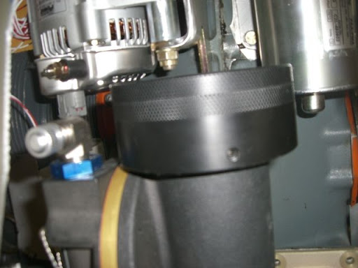

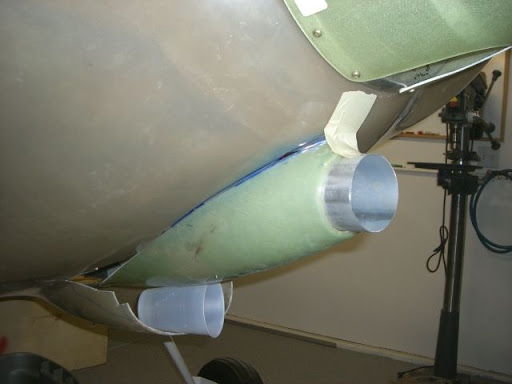

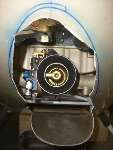

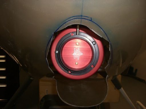

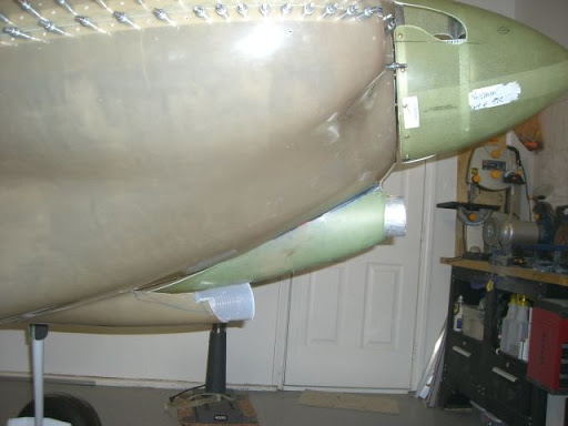

Just wanted to give you some feedback on the Rod Bower http://www.ramairforhomebuilts.com/contactus.htm. I contacted him and told him I was interested on fitting his system on my RV-4 (narrow deck IO-320). He said we could give it a try. I drove 3.5 hours to Visalia, CA to see him. I took my FM-100 fuel meter, my lower SJ cowling and my Superior cold air sump. I met Rod and a couple of his buds (good guys). We started looking at possibilities for the installation. Some of the existing parts he had would not work with my fuel meter. After unsuccessfully trying to find an air filter that would work without mods he decided the best thing to do would be to make an adapter. The adapter fits the current filter then reduces the ID to fit the fuel servo. We cut the cowling then he gave me 2 different units so I could play with them at home. BTW he did not take a dime. Then I drove 3.5 hours back home.

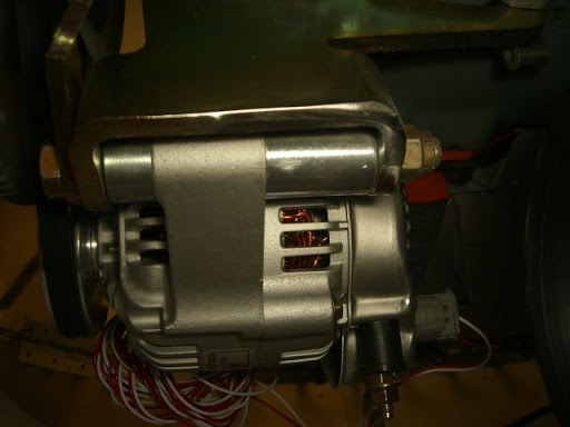

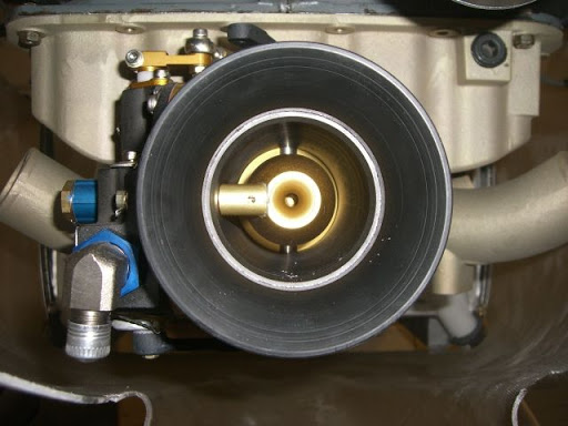

Yesterday, the adaptor showed up (he had to fabricate it). I fitted the system in about 4 hours (still have lots of glass work on the cowl). The only thing that did not go as plan was the bracket that holds the alternator. It was just a bit too long and kept the induction system from fitting nicely in its location. I called Rod and told him about it. He told me the same thing happen with his RV-8. So I carefully filled the alternator bracket. Here are some pics of the current installation. The system in these pictures is missing a couple of parts. I am really excited about this mod. I hope between the cold air sump and this induction system, I get better performance. I am trying to figure out how far forward to mount the intake ring. I think if I move it flush with the front of the cowling, I will get better MP. Figure that out later.
Inlet radius

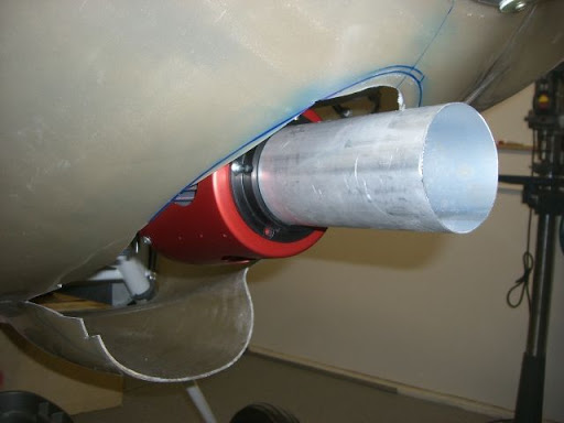

Need to put a radius on the tube that sticks out from the cowl. 1/4-1/2 inch radius will do. You will get a lot of loss and turbulence with the sharp edge of the tube.
Don
Don,
The tube is there only to hold the scoop in the correct location in relation to your fuel meter. That way I can move the scoop forward or aft and know that I am lined up. The connection from the scoop to the fuel meter will be made out of wet suit material. An aluminum ring (with radius) will be attached to the front of the scoop. Thanks for telling us about the potential for losses.
Do you know what would work best? Leaving the scoop were it is in the picture or moving the scoop forward so it will be flush with the front of the cowling.
Thanks for any help or guidance.

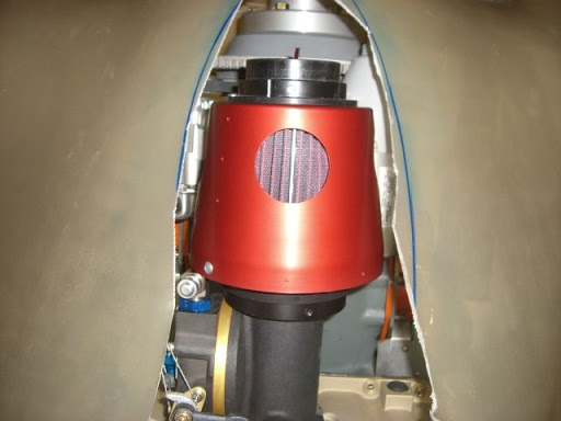

Axle, I put Rod's system on my 7 and I have the intake lip about 1/2" back from the front of the cowl. I get 1 3/4" more MAP from filtered to ram air. I adapted his 8 intake scoop to my 7 and it was not all that much work with great results. Don

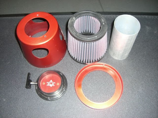

I have molds to make fiberglass copies of some of the Bower system components, with some differences.
Rather than have the filtered intake come in through reed-valve flaps on the outer chamber, I made a duct to go up to the left cooling intake ramp. The fiberglass chamber could be fitted with the reed valves, but I think that is less desirable.
The fiberglass parts to form the chamber for the conical K&N filter are what I have the molds for. To roll your own, you would have to make an adapter to connect the chamber to your fuel servo, and the butterfly valve that goes in front of the chamber to open the center to ram intake.
We might be persuaded to machine those parts if there was some demand.

Regarding the Rod Bower reed valves: I bought several varieties of plastic binders from Office Depot to make replacement reed valves. I found the 0.7 mm thickness work best. They have lasted 4 years so far and seem to work well. Go to the store armed with your micrometer!

This seems to be true. At least in the early first generation intakes. Gene Evans gave me one that he had so I can reverse-engineer it.. It was for a Rocket, and it has an RU-3600, noticeably bigger than the RU-4250.
Both are 5" long.
This was an early intake that had the bypass duct for filtered air that takes air from a window in the ram air duct ahead of the butterfly valve and brings it to the filter housing. An advantage of this scheme was that there was no reverse circulation through the filter when the ram air butterfly is open. A disadvantage is that it makes the assembly much longer, won't fit in a standard Vans cowl. It would fit in a Sam James or an extended Vans cowl that requires a prop extension.
When I looked at my housing, I think it was only 4.5" long, raising the possibility of a third size? When I get home from the Reno Air Races, I will disassemble mine and measure.
My hope/plan is to offer the ram-air butterfly valve installed on the filter canister, with filter and intake adapter for RSA5 and FM150, and leave it to the builder to install one of three concepts for supplying alternate air to the filter. 1) bypass duct from the ram air duct, 2) a snorkel bringing air from the upper cooling plenum, 3) reed valves in the filter canister.
I personally do not like option 3, as it brings air from the lower cowl plenum, which is warm and lower pressure. But that is the configuration of the later Bower systems. I currently have option 2 on my RV8, and I have 1/2" lower MAP on alternate filtered air than ram air. Part of that loss is through the filter, and part of it through the lack of full ram recovery in the upper cowl plenum and losses through the snorkel. I do not have a well-designed intake for the snorkel--it is just a flanged tube attached to the front cooling ramp, with sharp corners. a radiused lip, or even a small scoop might increase MAP some. Note also that with this scheme, there is probably some loss of MAP when on RAM air, because reverse flow can go out through the filter and through the snorkel up into the cooling plenum, if the pressure is substantially lower there. Honestly I think this is a very small effect.
Stay tuned this winter as I work on getting the parts made to re-introduce the system.

Hi Steve, I have an RV-8 (I am not original builder) that has a Bower ram air installation. The film/plastic sheath the sits just inside the outer housing is crumpled at the back and I wanted to replace this. Do you know what material this is? I was thinking of using a mylar sheet and cutting out a replacement (maybe 1/32"). Any suggestions? Thanks.
Mike Prior N874DE
Mike Prior N874DE
Hi Mike,
I'm not a fan of that reed valve system, primarily because it pulls air from the lower cowl area for filtered air. That air is pretty warm, so there is a loss of performance when you need it most, for take-off. The other issue is what you and many others are experiencing now - that after a handful of years that plastic deteriorates and stops sealing, so you have a ram-air leak path into the lower cowl plenum when running on ram air. This interferes with engine cooling by raising the pressure in the lower cowl, wasting the ram air.
I'm on the verge of announcing a couple of improved solutions. I am on hold waiting to get parts back from a machinist who promised me 2-week turn-around and it has been about 6 weeks. Please stay tuned.
Steve.
Mike Prior N874DE
I made replacements out of mylar when mined needed to be replaced. It didn't last. Rod sent me replacements and they are still working.
