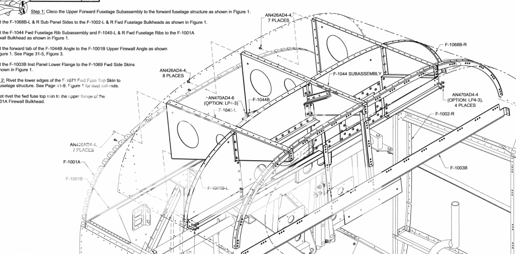

So I finally got my upper instrument panel assembly installed onto the fuselage after wiring it up on the bench. My engine has already been hung and I can see a few of the rivets on the firewall that connect with the forward ribs of the instrument panel will be a challenge to get to.
What have other people done to get these rivets? Back riveting? Cherrymax?

Actually Bill I was referring to the upper three ribs of the instrument panel rather than the cowl attach flange on the firewall, but I get your point. We were able to bucket all but 6 of them. I am going to try some cherrymax structural rivets in the few remaining spots on those ribs.
Sorry I misread your post. I installed those rivets prior to installing the engine mount. I would imagine that using Cherry Max rivets would suffice.
